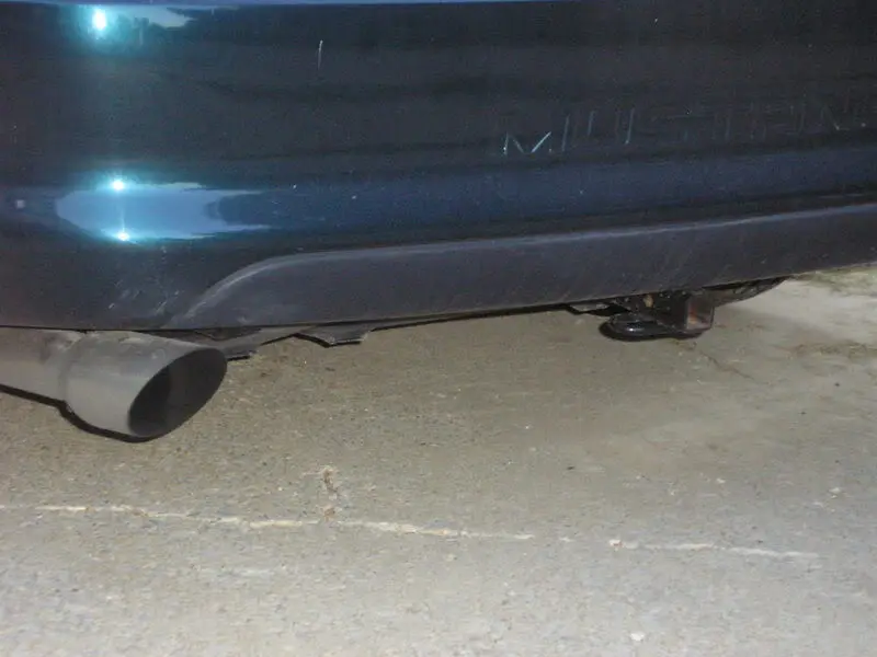

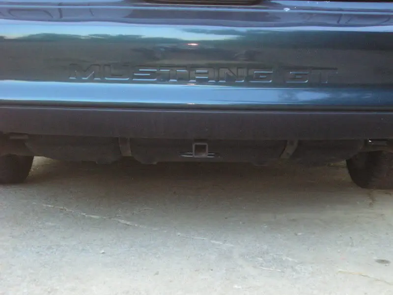

ive got a hitch on my gt. its not really even noticeable. its tucked under the bumper and you can remove the bracket that the ball is bolted to. i got it to tow small things and i also have a 15 foot boat that i tow with it. i will say that the car will tow the boat as good as a smaller truck. i will post pics of the hitch. i got it from a local trailor shop and it cost me about 160 bucks installed.

Heres mine

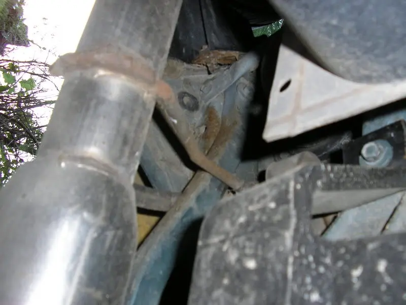

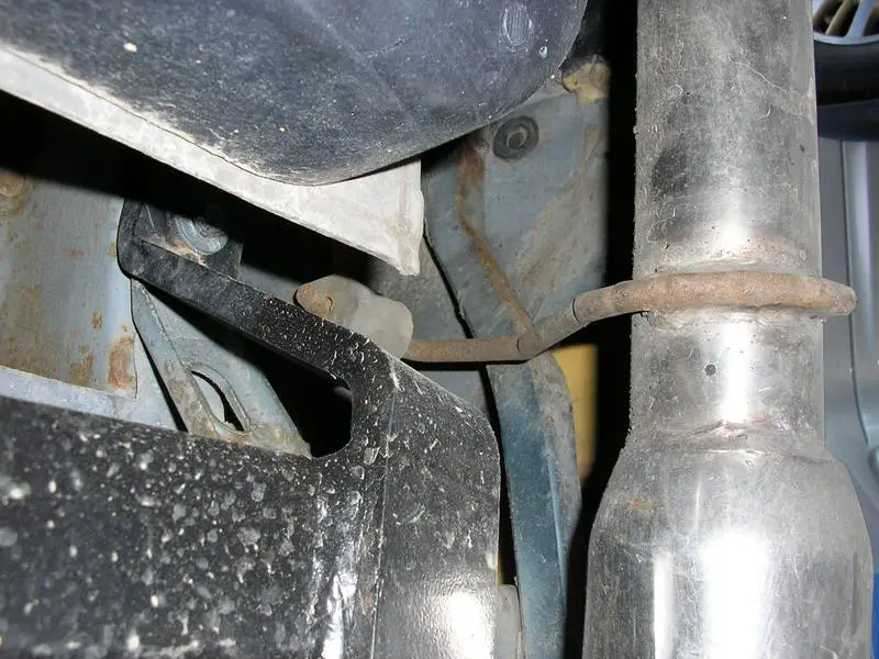

Here you can see the two bolts on the drivers side
These bolts are already in the car

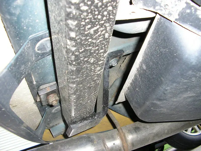

The two on the actual bumper beam you'll have to put in yourself. I had to cut a 1 inch by 1 1/2 inch hole to get a plate and carraige bolt in it.
