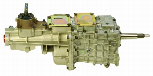

Ok guys its getting near the time i just have to do something. I was going to pick up a 3650 from someone but getting parts for a 3650 is impossible. My choices are get a rebuilt t45 and cross my fingers i dont break it again because there are no upgrades for these tranny's. Tremec's specs are up to 325tq while a 3650 is 360tq. Only thing that can be beefed up on a t45 is the forks and viper bearings. A rebuild for my t45 just got off the phone with someone is 6 hours labor(probely a little more cause of the lt's) plus parts. A complete rebuild kit is 360 dollars, plus around 30 dollars for the better forks, and i have to buy whatever gear is broken...probely around 100 dollars. All said and done around a thousand dollars. Or I can spend a more money and go with an automatic with a jerry mod, multi disc stall converter (4000 - 4200stall). The stall will be around 900 dollars, i can get a deal on a tranny, and odd's and ends needed will probely be another couple hundred(waiting on prices from salvage yards for swap parts). All said and done around 1400. I can however sell all my 5 speed parts(tranny, basicly new clutch, alum flywheel, pedal assembly, shifter, etc)
