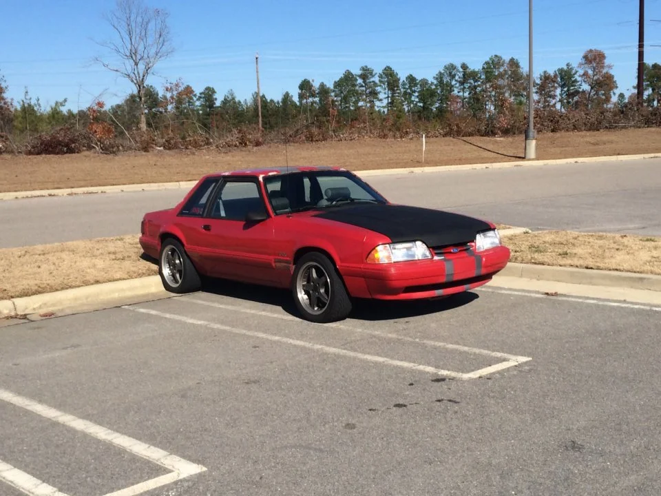

Sure will!!! I am looking for a 2nd trans to rebuild and make perfect. Unfortunately I cannot have m car down that long so I am looking for one that needs rebuilt. And where can I look to see what gears I have in the rear end?? I believe it is still factory gears. Mine is a 1990 5.0 5speed LX Coupe. Thanks!!!! Here is a recent pic of my Lady!!
If your gearing is factory, it may have 2.73's. There will be a tag on one of the cover bolts, and it will have something like 2L73 stamped in the lower left of the tag. If there is no tag, you can use tape on the tire and drive shaft to determine the axle ratio without removal of the cover. Count the number of rotations of the drive shaft to one rotation of the tire. For example, if the drive shaft turns 3 3/4 turns for one tire revolution, then it has 3.73 gears.

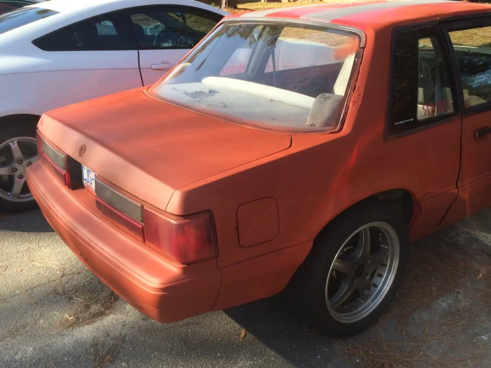

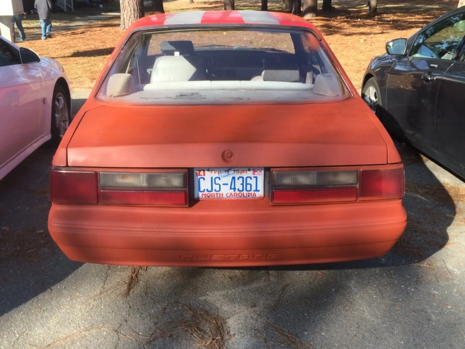

Oh and updates on the car. Started body work. I am learning on my car. Tell me what you guys think. I know it's not even close to being done yet. The overspray is taken care of so just ignore that little bit. lol

Looks good, keep up the good work.
