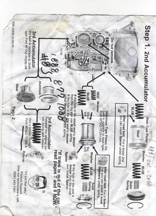

specifically I need the instructions on the 3-4 accumulator piston and springs install diagram.
My manual shows only 1 spring in between the accumulator and retainer. Shoulnt their be another between the trans and the 3-4 accumulator? the printed instruction show this.

I know it says: follow instruction blah blah blah, but on so many kits sccoa and neptune .com's websites, both had a tappered yellow spring between trans and accumulator on our year models.
Not many posts, well are the instructions exactlly the same on the HD-2, mines came in a black box with the video. same as this one pictured minus yellow spring.
