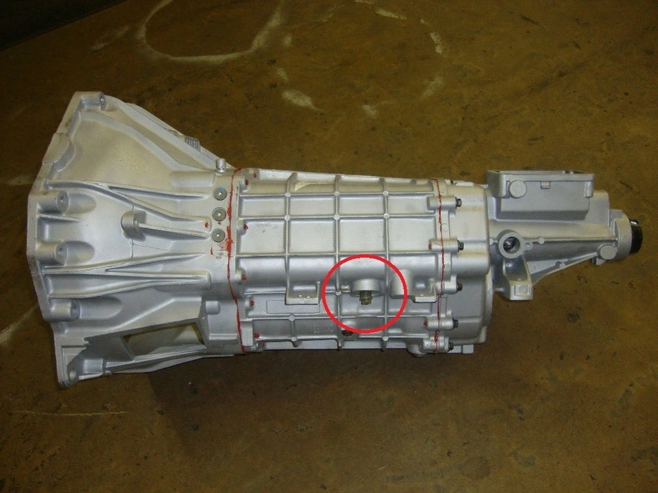

I swapped in a '01 3650 when I broke my original in my '04 back in 2007. Everything was the same except for the sensor for reverse. The connector was different. Just swapped the sensor one from original trans to the replacement.
Best picture I could find online. Circled the sensor that may need swapped.
