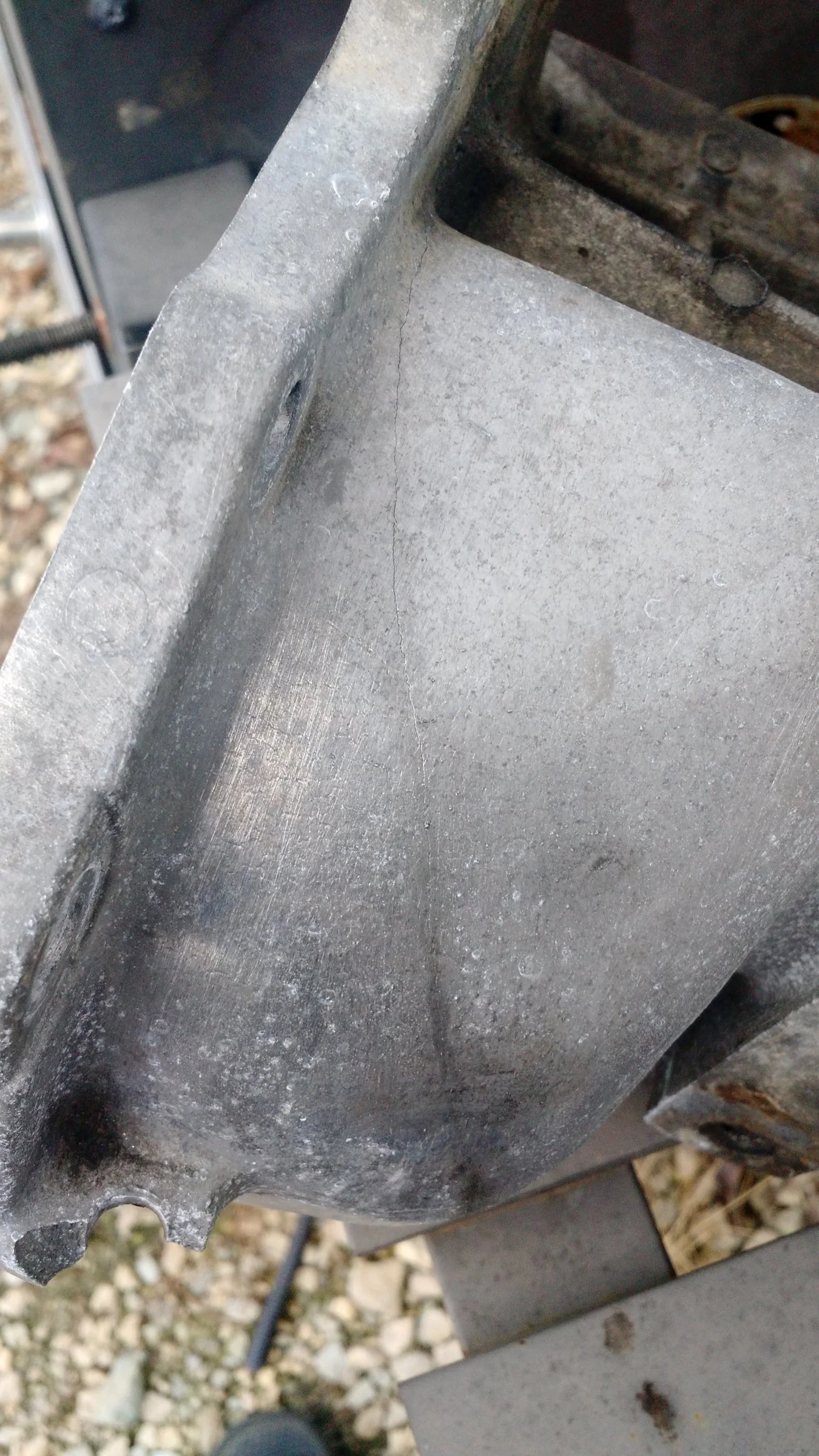

My 93 mustang hatch 5.0 5 speed keeps cracking tailhouseings and I've been through 2 now and cannot figure out why

Not much to go on- but my first thought would be-
-Vibration(s), many causes here, a couple would be Bad U joints, unbalanced driveshaft, bad pinion bearing..
Is the car lowered ?
If it's lowered could it be jamming the driveshaft into the trans.
Is it the original driveshaft to the car?
Is the trans mount in good shape?
Does the car make a bunch of power?
Wish I could be more help,hopefully some of my suggestions might help you. Hang tight and smarter people will pop in with things to check etc. lol
Like maybe @Boosted92LX ,he may have an idea :D
I think @RaggedGT hit most everything I could think of off hand. Bad output bearing maybe allowing excessive runout leading to stress cracks. Maybe pinion angle binding the u joints.
Reactions: RaggedGT
The stock driveshafts in these cars were trash. Very bad about vibration. The only known cure is the aluminum ford racing shaft. (Common fix) I put one in my car and it was smooth as butter afterwards. That vibration will tear upall sorts of stuff.
Reactions: RaggedGT
