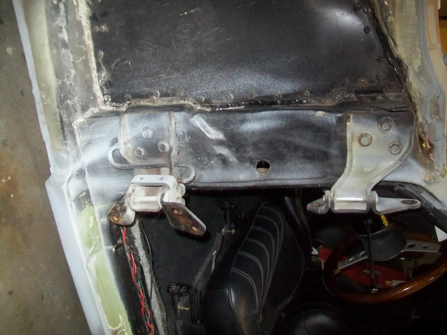

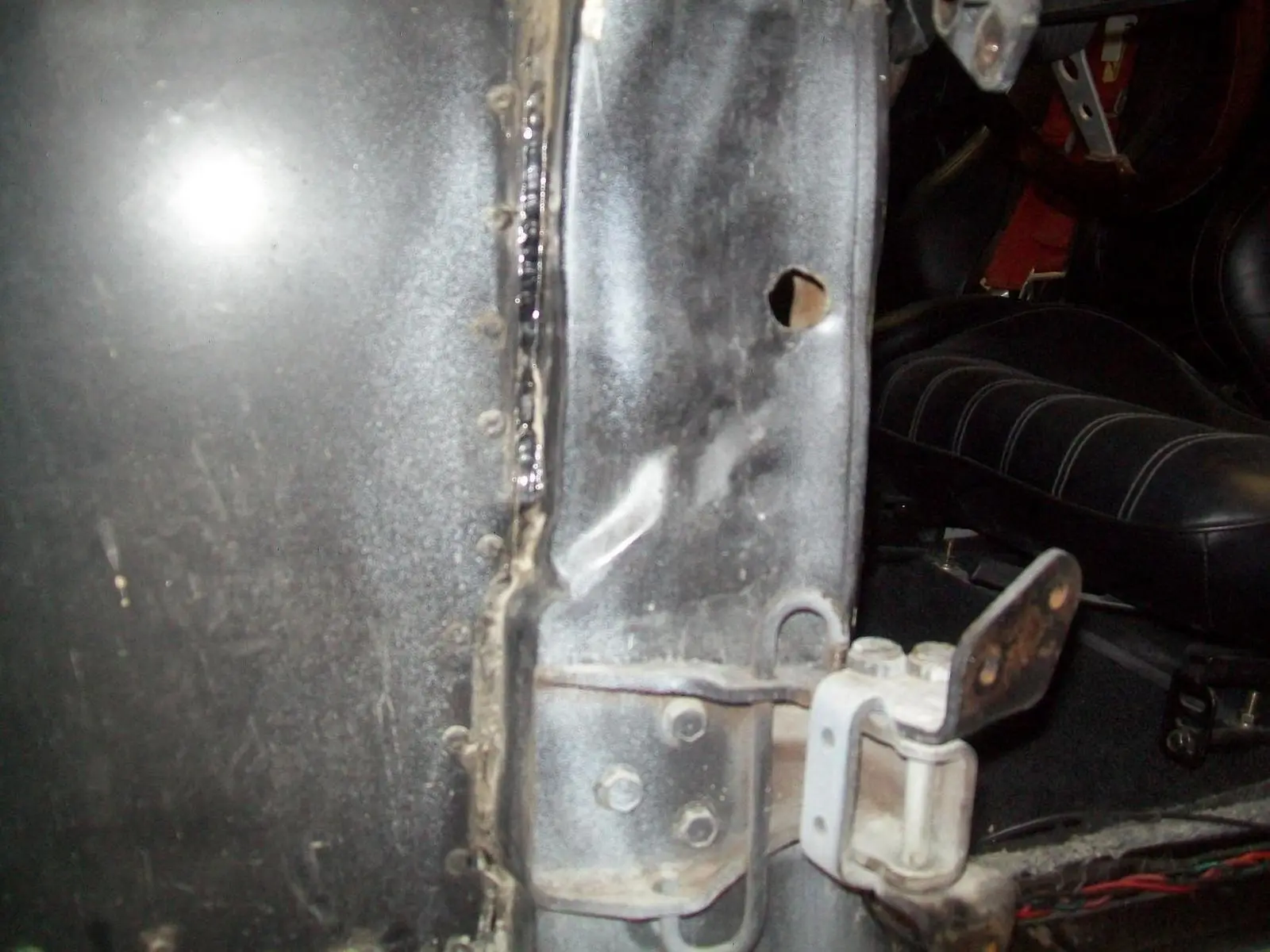

I have a 1968 mustang and the driver side door does not hang straight took fender and door off and the door pillar is mangled. Is there anyone that repops these or do i have to cut one out of a different car. What cars besides a mustang would have the same door pillar.
thanks any help apprechated

You have bigger problems than the pillar. Your cowl side panel is a plain piece of sheetmetal pop-riveted in place. This means the whole structure of the cowl is dangerously weak.
The pillar part you need is listed in the Glazier/Nolan Mustang Barn catalog as G10932. The side cowl you need is G10860. You need to look over the rest of the car. The photos you posted show criminally-poor quality repairs. Much more of that and you could die in the car just hitting a pothole.
That area should look like this:
Thanks for the information. I have gone through the rest of the car and the quarter panel was a little damaged and there was some damage on the rocker but i was able to striaghten that up.
