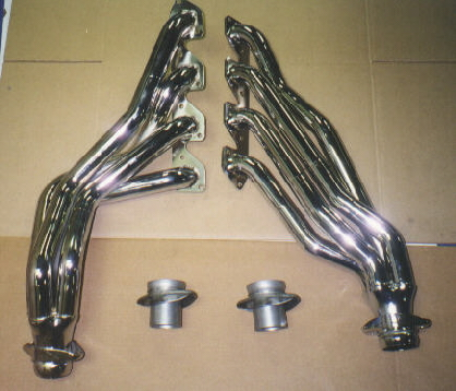

I have run into one last issue on my Tremec TKO swap. I have 67 with 351C-2V with TKO in place. I am using a Mcleod scattershield and Mustang Steve cable clutch conversion kit. My problem is my exhaust pipe/ manifold outlet(stock FOMOCO cast iron ) on driver side is right in front of cable hole on scattershield and thus cable hits hard on pipe right at outlet flange.
Has anyone got info on headers that will work? I really would prefer shorty headers and avoid the power steering lowering bracket issue. Sanderson Headers has some but I dont think they will work.
Any help appreciated.

http://www.fordpowertrain.com
