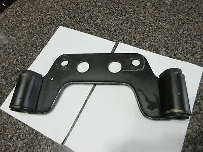

If you're swapping it in to replace a T5, what do you do for the H-pipe exhaust hanger that normally mount's to the bottom of the T5's tail-shaft housing? I don't recall how that's don on a FOX3, but there's a hanger attached to the trans on the '94/'95s.
its separate on the fox. It sandwiches between the trans mount and the trans when you bolt it all together
