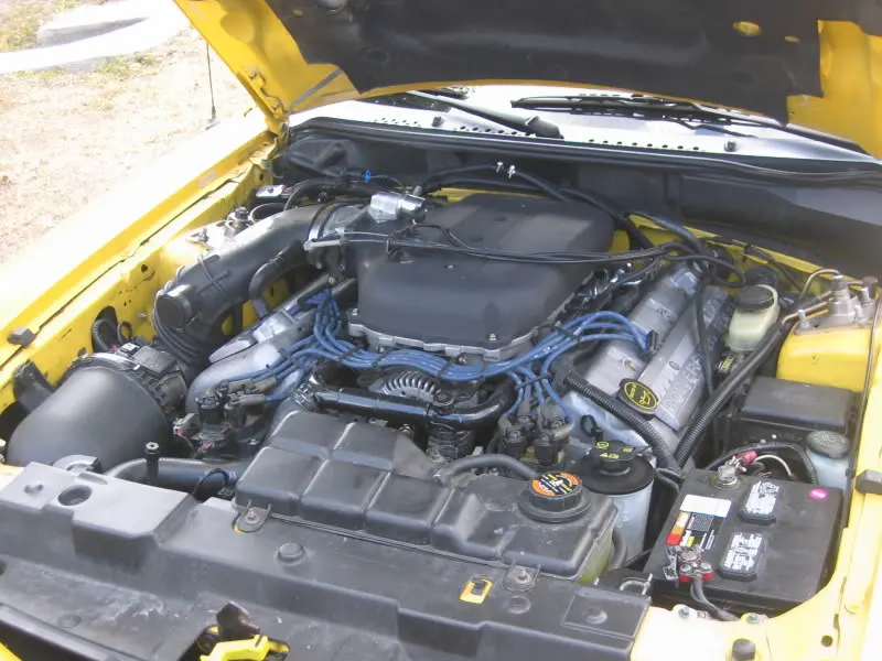

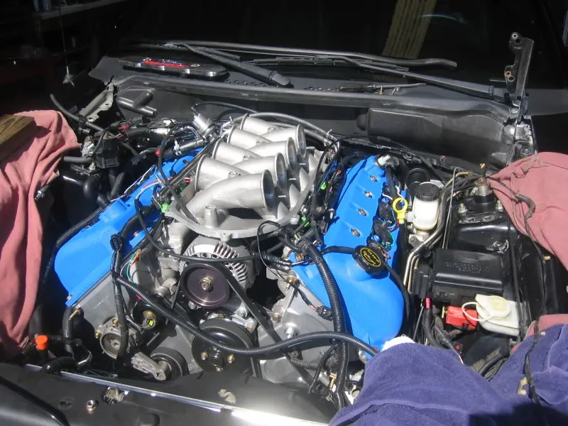

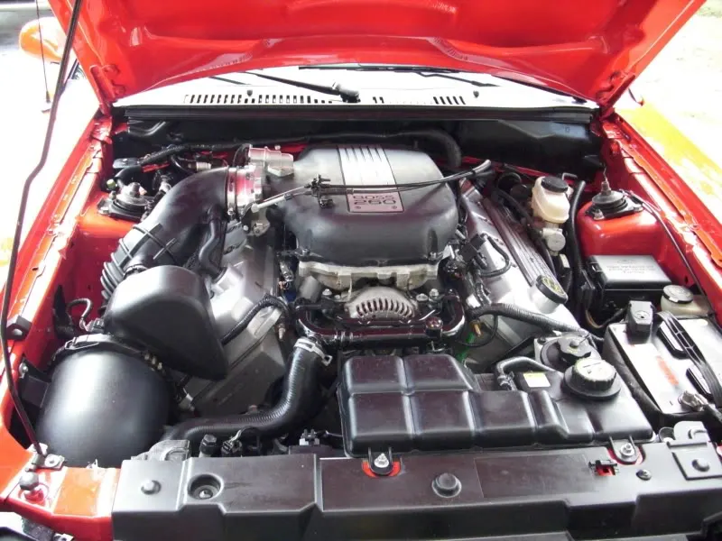

birdman941 said:
Yeah, uh huh.
Uh Huh part 2
Slow, stock Navi motor w/Boss intake:
The thread is about NA 5.4 2v's. Stay on topic.
