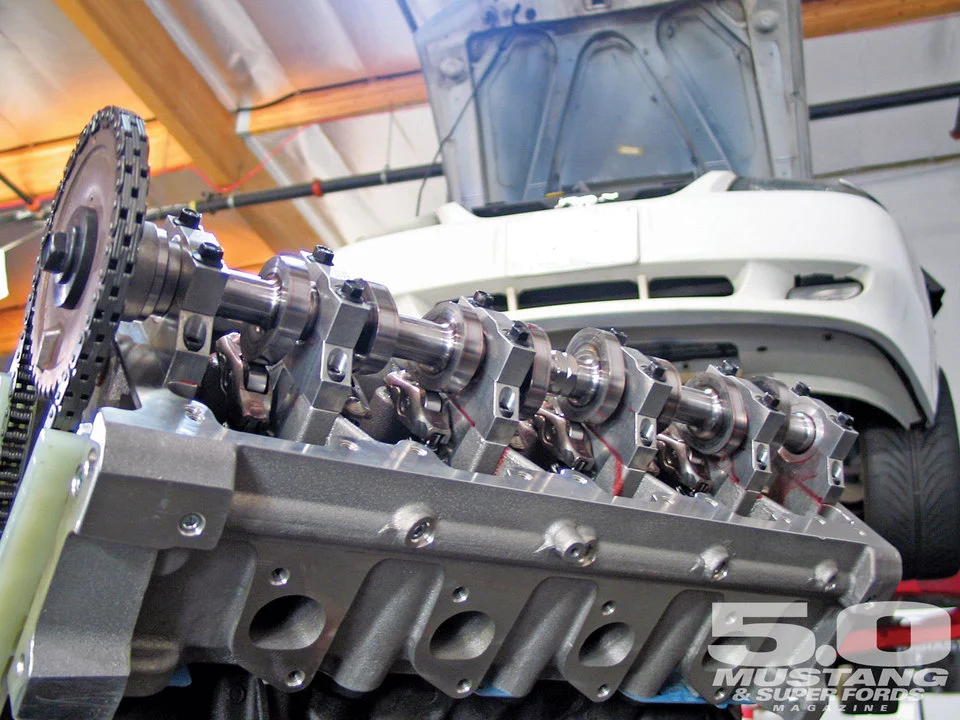

Observe:
Noise cannot be rockers striking the covers...

I was sitting there staring at a 2v head I have at the shop with stock 02 covers and just couldnt fathom how in the hell they would hit. What does a 2v 96-98 head cover look like?

trinity, those are some mighty fine looking caps on that cam! Where did you get those?
I cannot imagine how they would contact either. Sleepygreen, pull the covers and you should be able to see what we are talking about if you cannot get it from trinity's hot head pic - what head is that anyway? Looks sweet.
