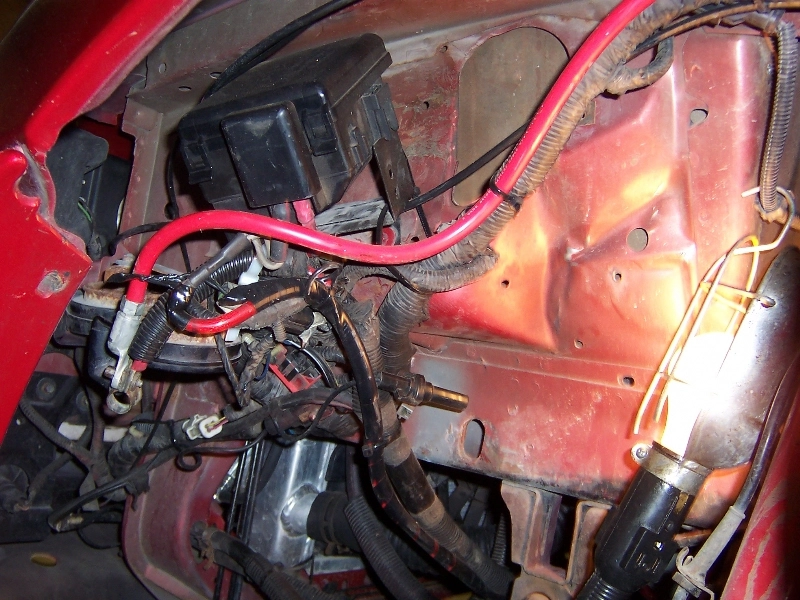

Also anyone know a link to a step by step process for moving the fuse box into the fender well?

On the fuse box, unplug everything that needs unplugged, move it, then plug everything back in. ;) I know, probably not very helpful.... I think I bolted mine to the horn bracket. I have a pic somewhere, I'll find it later when I get some time.
I had to extend the alternator wire, and I ran it along the sway bar under the frame rail. I may have had to extend the starter wire too, but I can't remember.
Here you go. The battery wire didn't work too well like that so I have since ran a larger wire straight to the starter.
