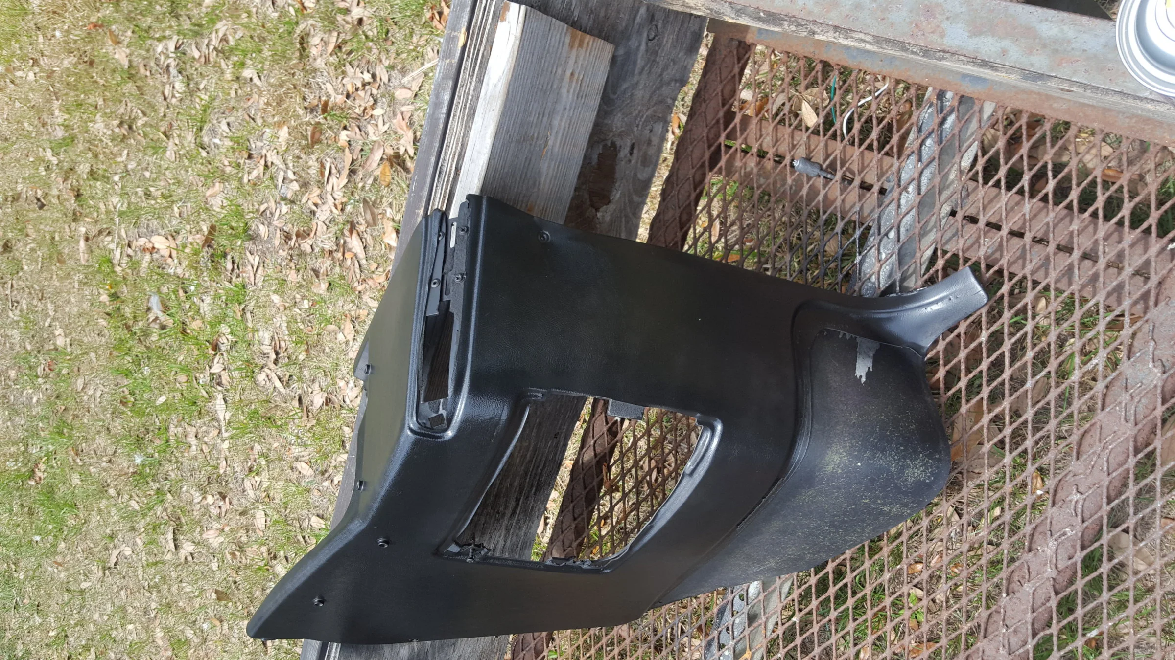

That kit looks like it does a great job on the interior panels. Fortunately, my interior panels are near perfect...
I probably should have specified that I was inquiring about exterior trim. My bad.
Thanks for the reply!
Kevin
I think LMR sells SEM 39143 trim black, which is what I've been using for the exterior plastic parts that I've refinished.
My main concern was the metal upper/side windshield trim. On the notch/coupe cars this trim is sold on the aftermarket and can be replaced with new. I'm guessing SEM 39143 is the correct finish color in this case.
The convertible top/side windshield trim pieces are metal and attach much differently than the pieces on the non drop top cars. I haven't seen it available aftermarket and I'm not sure that's it's been reproduced. The part of the upper trim that was under the top for the past 27 years was a semi-gloss black.
Just wondered what Ford used on these pieces. More curiousity than anything at this point. I'm fairly certain that I can get the look I'm going for with SEM 39143 and a little hand polishing.
