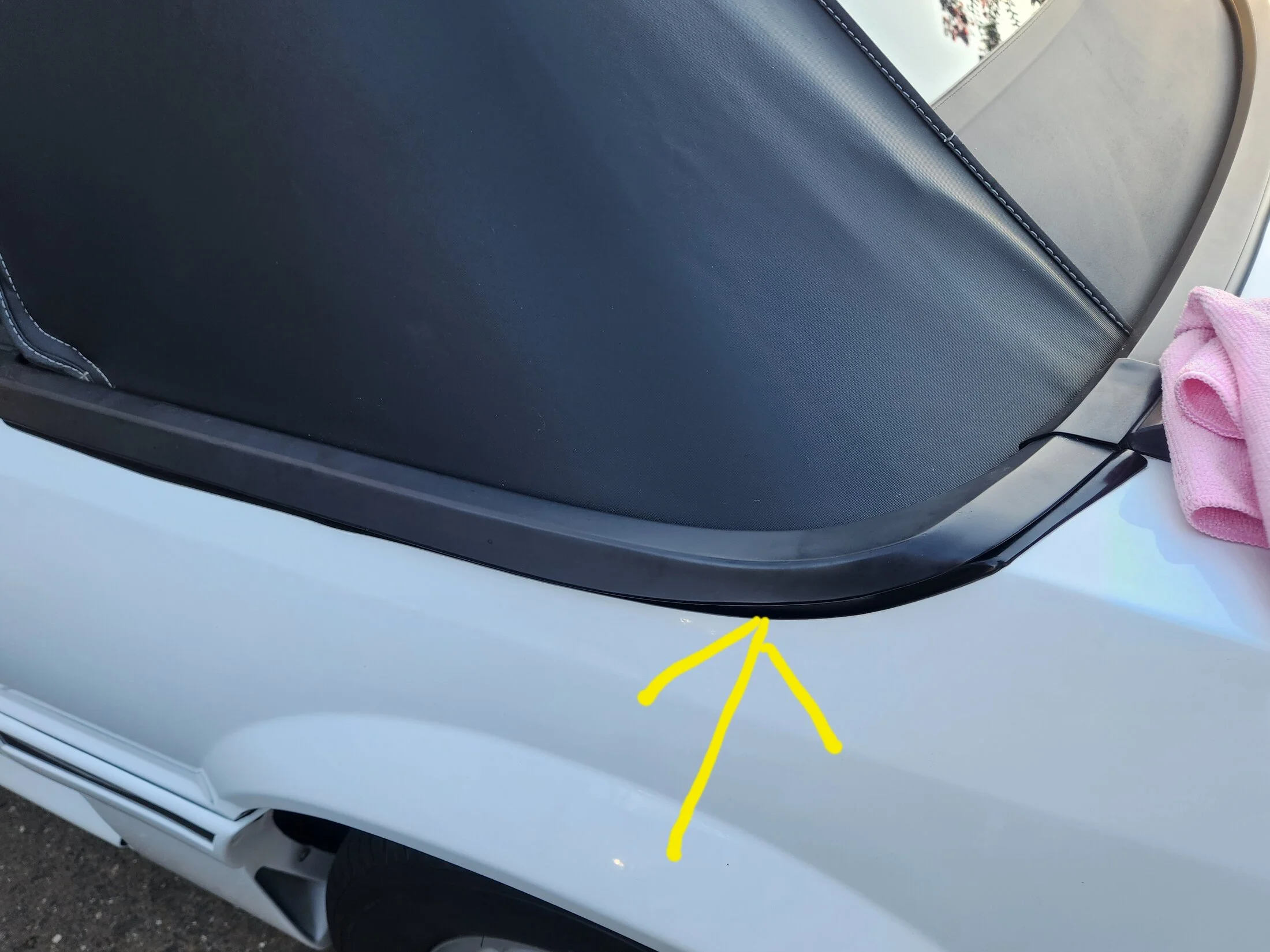

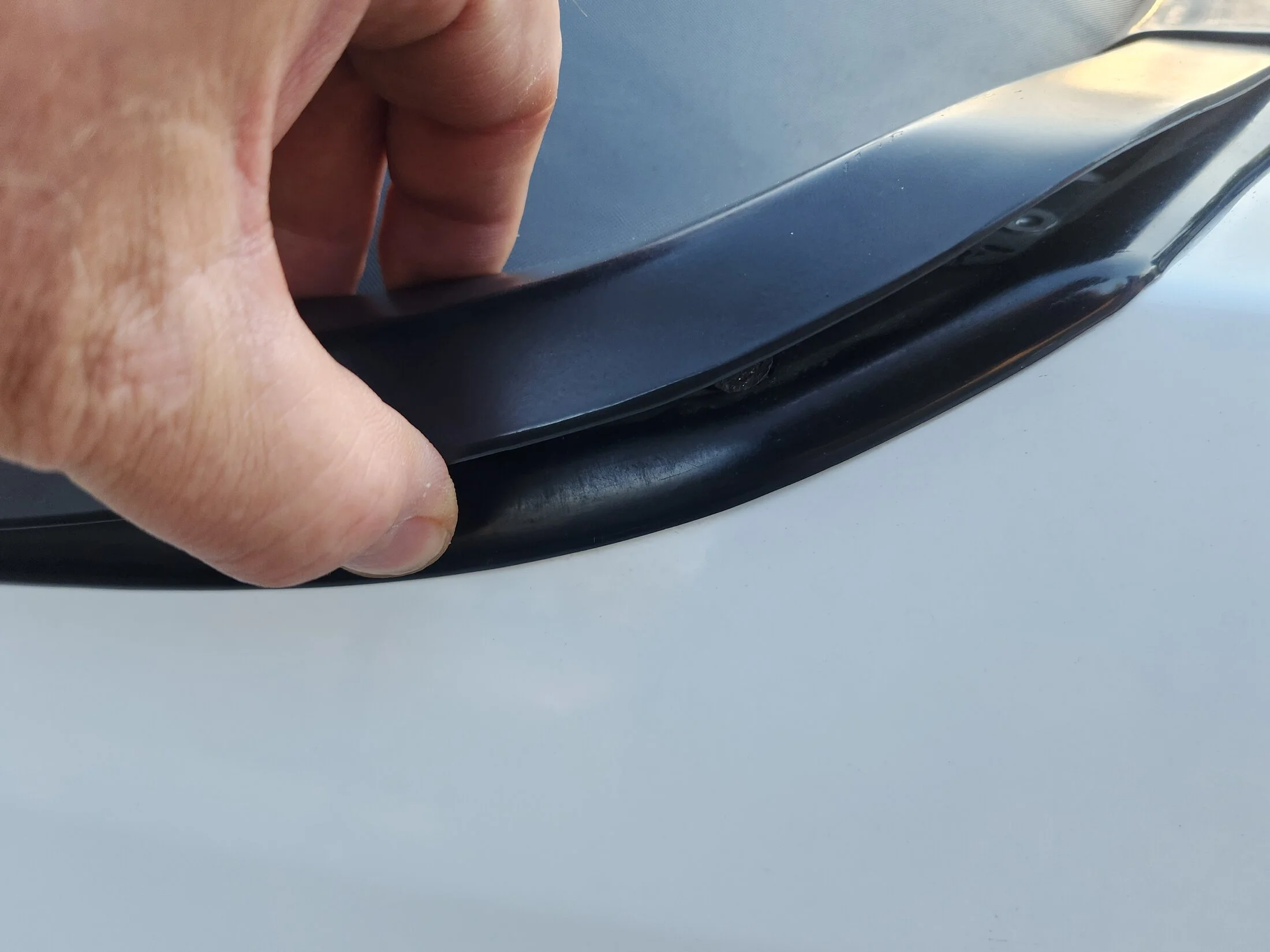

C CJ_GT Member Aug 6, 2023 17 5 13 California Sep 16, 2023 #1 Sep 16, 2023 #1 The trim where the boot slips under and secures is loose and coming up. Does anyone know a quick fix for this?
qikgts Active Member Nov 12, 2001 117 58 38 FLORIDA Sep 17, 2023 #2 Sep 17, 2023 #2 I think the best fix may be to replace that piece of trim. There's likely a stud broken off on yours.
Mustang5L5 That is…until I whipped out my Bissell Mod Dude Feb 18, 2001 43,260 17,945 224 Massachusetts Sep 18, 2023 #3 Sep 18, 2023 #3 I believe there is a stud in that area that is lifting. Looks like yours is broken. Check out this video Reactions: General karthief
