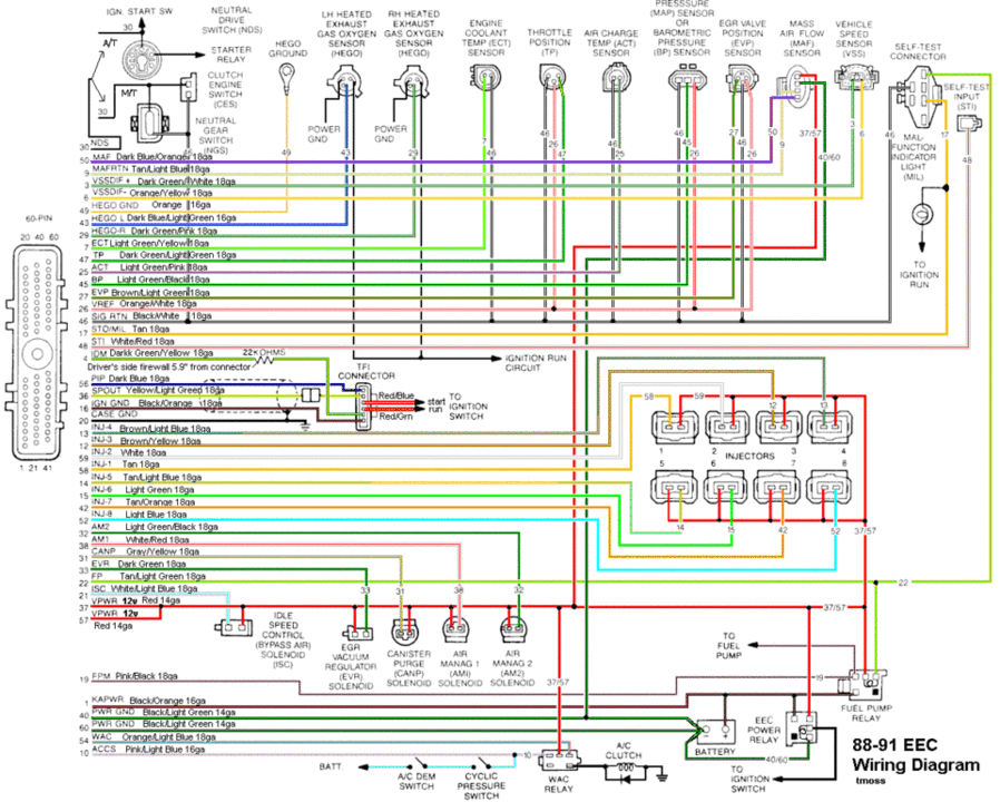

Code 15 - No Keep Alive Memory power to PCM pin 1 or bad PCM (Memory Test
Failure). The voltage to the Keep Alive Memory (KAM) is missing (wiring problem)
or the KAM is bad. The KAM holds all of the settings that the computer "learns" as
it operates and all the stored error codes that are generated as a result of
something malfunctioning while the engine is running. Use a voltmeter to check
the voltage to the pin 1 on the computer - you should always have 12 volts. No
constant 12 volts = bad wiring. If you do always have the 12 volts, then the KAM is
bad and the computer is faulty.
If the computer has to "relearn" all the optimum settings every time it powers up,
the initial 5-30 minutes of operation may exhibit surges, poor low speed performance,
and rough idle.
Note that some aftermarket chips will cause code 15 to set. Remove the chip,
clear the codes and retest.
Before replacing the computer, remove the battery ground cable for about 20
minutes. This will clear all the codes. Retest after several days of running. If the 15
code is gone, then don't worry about it. If it is still there, then you get to do some
troubleshooting.
Wiring diagrams for the proper model years are next…
For 86 models see http://www.autozone.com/images/cds/gif/large/0900823d80167158.gif
For 87 models see http://www.autozone.com/images/cds/gif/large/0900823d8016715e.gif
For 88 models see http://www.autozone.com/images/cds/gif/large/0900823d80167162.gif
For 89-90 models see http://www.autozone.com/images/cds/gif/large/0900823d8019595f.gif
For 91-93 models see http://www.autozone.com/images/cds/gif/large/0900823d80195960.gif
See the following website for some help from Tmoss (diagram designer) & Stang&2
Birds (website host) for help on 88-95 wiring http://www.veryuseful.com/mustang/tech/engine/
