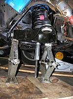

More Pics at: http://www.veryuseful.com/mustang/tech/tmp/OTC-spring-tool/

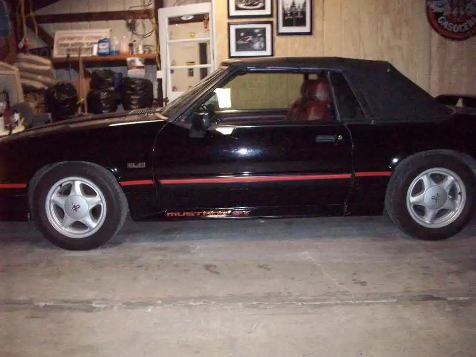

I have Steeda sport springs with Steeda CC plates and their bump steer kit (yep, label whore) and after the steering rack was replaced with new bushings the thing drives nearly like new. I dont find the ride harsh or the car dragging on stuff as i pass over, no more than our stock height Xb.
Give me a little bit and ill go take a pic of my car as it sits with the steeda sport springs and energy suspension isolators.

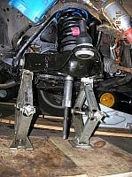

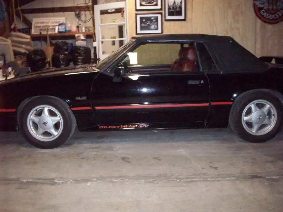

I got lucky and found my springs on ebay a long time ago, NIB I think I paid a little more than half of what they cost from steeda.

FWIW, putting in any decent lowering spring that does not hurt handling may also likely need/be_aided_by the OTC compressor. I put in the lower Mach1 springs, and as you can see with the FCA removed. Still, even with the compressor, it was a hassle. Yea, if people do springs many many times, you can get the hang of the right way to align and cram the ****Ing springs in there. I know that some people will also use a big *ss sledge hammer to BASH the springs in. A friend did that for my lowering springs on my t-bird. I found out that it was semi-common practice. WOW, talk about being non safe! I did have a safety chain, but a the dynamic forces involved in a wayward spring could have popped that chain.
Hmm, I don't know about other people, but MY life is well worth the ~$200. Besides, IMHO, if you can't do it correctly and safely, then don't do it at all.
