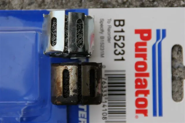

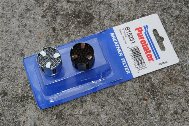

Although I haven't taken my emissions test for 2011, I just replaced the PCV Valve along with new hoses. My car has 271,000 miles and I never knew that there was a Crankcase Filter sitting below the PCV Valve that also needs to be replaced. This may have been a part of my problem with emissions. I installed a new one and will let you guys know how my test turns out next week. Removal is easy once you get the grommet and valve removed. I used a pick set from Autozone and it pulled out with ease. See photos of a 271,000 mile filter compared to a new one.

You can take that breather filter out real easy with a magnet too. Good cats go a long way.
