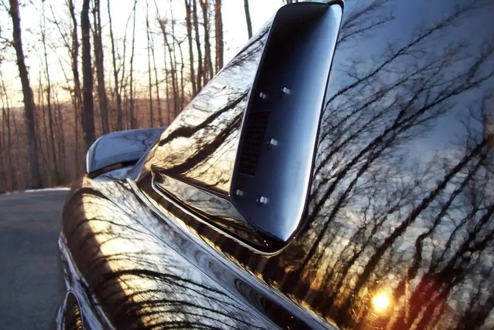

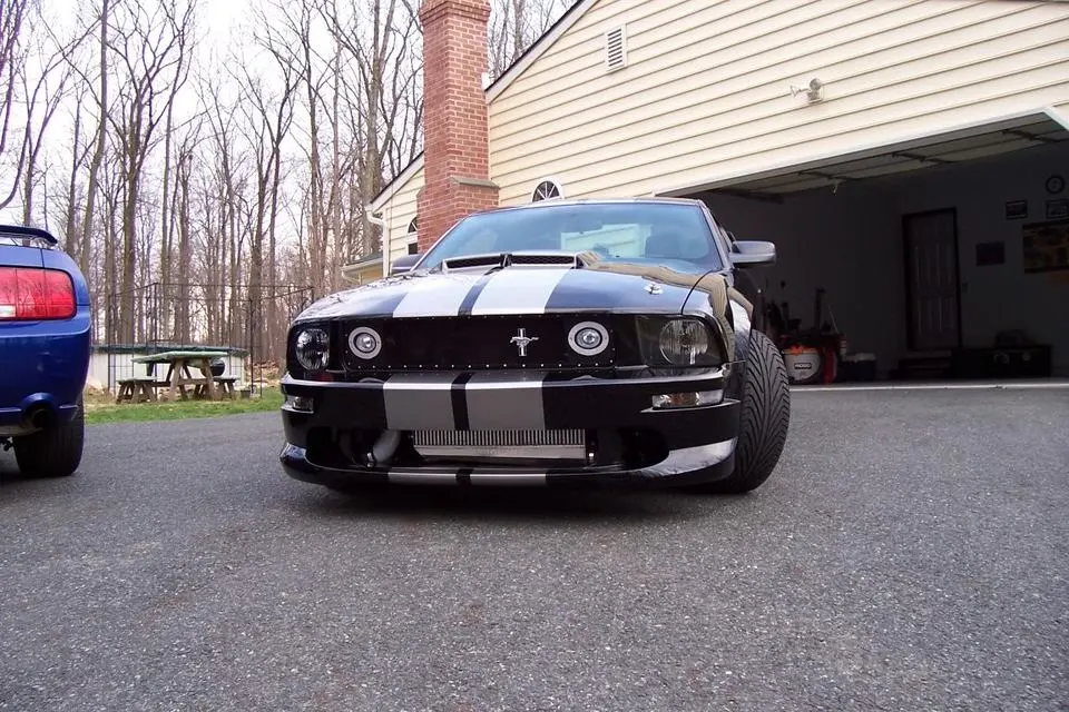

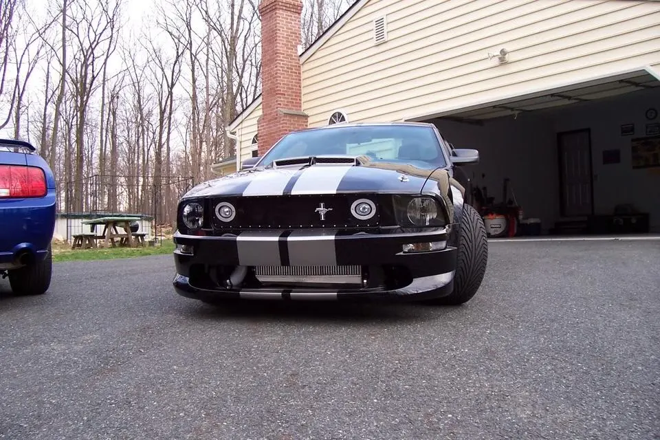

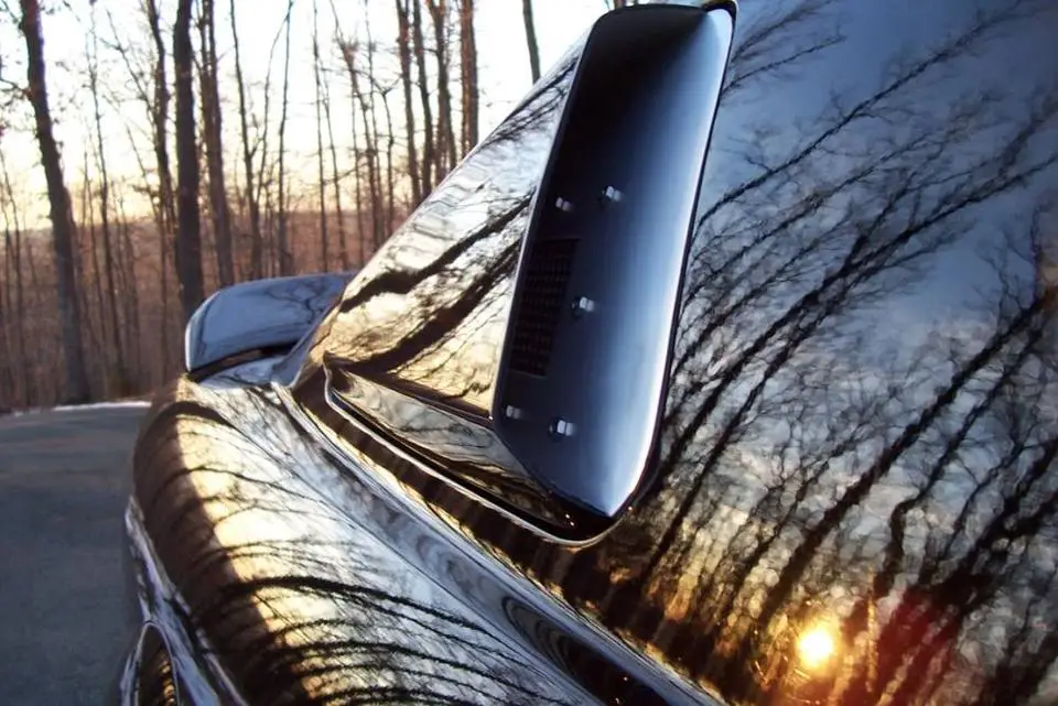

No, my toes are fine. I don't know what pics you saw of my car, but it's been changed up a few times. I don't have many decent pics and I recently installed a CDC ducktail spoiler which I have no pics of yet. The Procharger is coming off this fall/winter and I'm putting an intercooled Whipple on. My boy is getting the Procharger for his '05. The picture of the window scoops don't show the machined caps that go over the nuts (inside the scoop)
