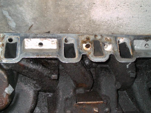

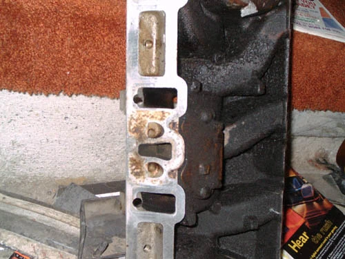

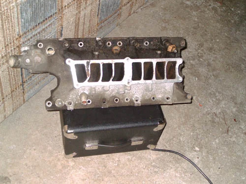

well, i have a lower intake off a truck 302, and ive heard, and it LOOKS like it will match up with the systemax II upper... ports match in size and location the same... but what im not sure about is the injector location, it looks like they are set back alot... maybe its suposed to be like that?
attachment.php
attachment.php
and does anyone know if those 2 will match up? like, have done it before or seen someone do it? thanks :nice:

The ports on the Holley are alot bigger where they enter the head and externally appear to curve less. The truck lower has port exits comparable to a 5.0 EFI and needs to be ported out to even come close to taking advantage of the Systemax II upper. For the cost of an upper, you might as well get a used Performer, Cobra, or Explorer intake.
