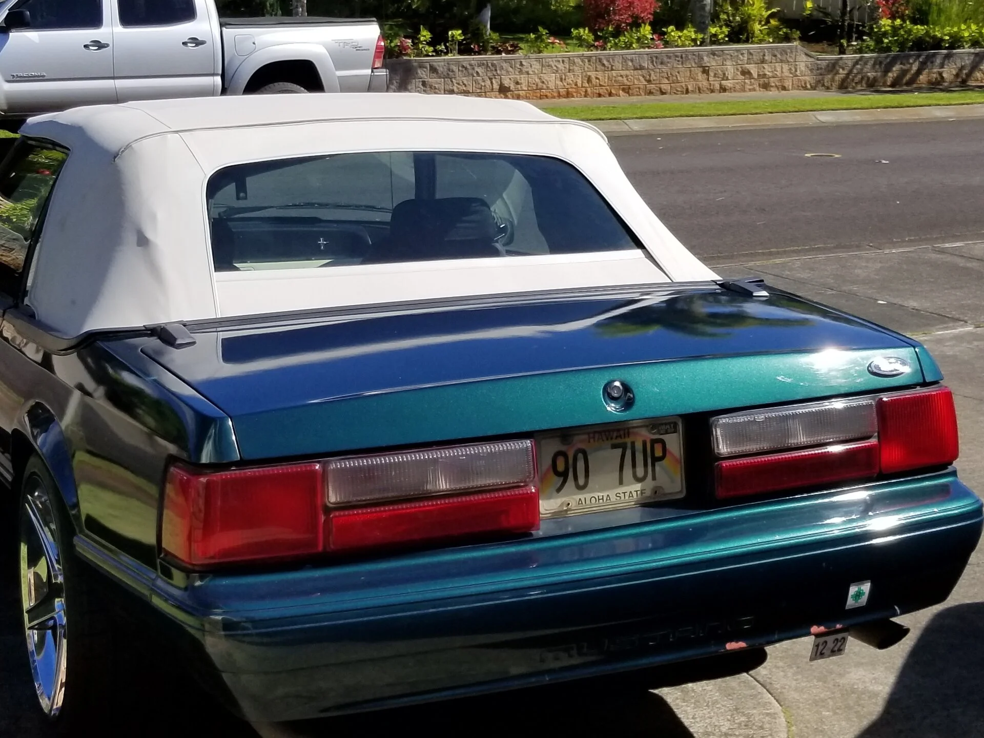

A newbie question here. I bought a 1989 Fox convertible which needs restoration. It has a trunk lid with rails on it (the "Continental" look?) :shrug: Anyway I would like to find a smooth trunk lid with no holes in it and maybe feature a conservative wing or spoiler. What are my options here? Thanks

Get a coupe trunk lid. They even sell aftermarket ones. Then just drill the holes needed for the mount. That's what I did.
I had a factory fiberglass trunk lid on my 89 gt convertible. If going fiberglass make sure it's a bolt on style not pin on ( race car ) style.

My understanding is that the only decklid that came from Ford was steel - but I'm not a notch/vert owner so perhaps there is something I am not aware of? I assume that a luggage rack was just bolted onto the steel decklid, and the same with the special edition spoiler cars.
I tried a fiberglass lid because the original was rusted out and the steel part was more expensive. I got what I paid for. Fit lousy and trying to get the latching hardware to work was impossible. Wasted my dough.
Get a steel lid. Or, remove your rack and weld the holes closed. My 2 cents.
