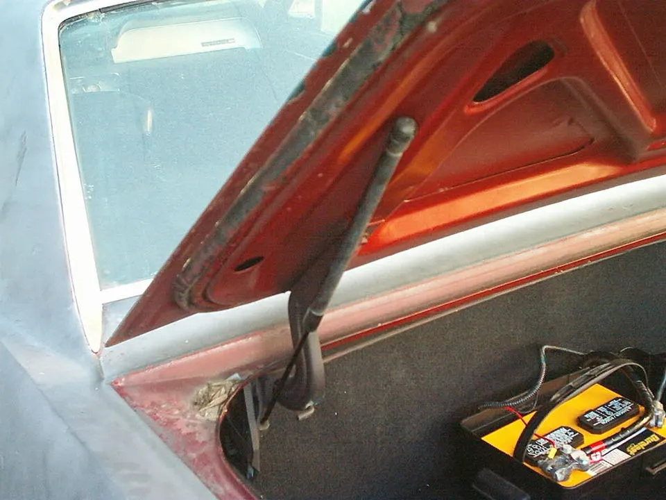

The other day when I got into the trunk of my 04GT, I started wondering about how easy it would be to convert my 68's trunk lid to lift supports, like the 04, instead of those stupid rods. It actually looks like it would be pretty simple.
I'm going to pick up a couple of trunk lid support shocks and experiment with them. I was just wondering if this has crossed anyone else's mind?

I adapted a gas lift to lift/hold up the trunk on my 69 Mach 1. Used a half-worn-out lift from a hatchback in the wrecking yard - a Hyundai I think. Works fine, looks neat, cost about 10 bucks.

We used some universal struts which are available from most parts houses. Used 100# struts (2), fabed a small bracked for the floor mount - used angle aluminum. As we have a fiberglass decklid, carved ouot a piece of aluminum to fit in the "u" shaped portion of the hindge. We made it a fairly snug fit and only required 1 bolt to hold it in place. The length and the spring rate will vary depending on where you mount/angle the bottom of the strut. Works great, we'll dig up some photos

I made one using a gas lift from another. car Cost me about $10 and an hour or two.

I ended up using the shocks from a 96 Mustang that someone gave me. I have nothing invested in it!

my setup uses the struts and ball studs from a saab 93... comes up nice and slow, really slick. i think mine are 60 lb. struts.
