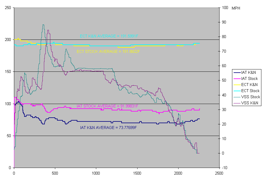

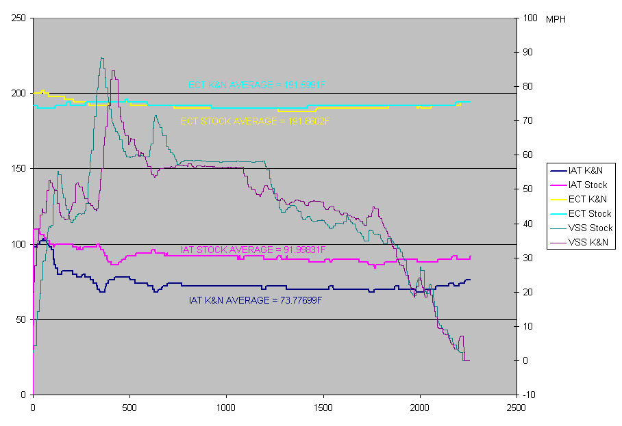

Here are some of my findings. It's stock intake with no silencer vs K&N FPIK.
What the K&N does do is:
- Lower intake temperature
- Higher mass air flow
As for how much horsepower that will translate in, I cannot tell.

So i just received my K&N intake and I decide to do a couple of test and datalogs.
Temperature today was 55.4F and the two test were done without one hour of each other. The car used is a 2001 Mustang GT. The stock intake used had the silencer removed.

The next run is a 1 mile higway run from one exit to another. I tried to keep the same speed and driving habits so the data can be relevant.
STOCK
IAT MAX : 110F
IAT MIN : 84F
IAT AV : 91.99381F
ECT MAX : 196F
ECT MIN : 190F
ECT AV : 191.8602F
MAF MAX : 19 910GM/S
MAF MIN : 538GM/S
MAF AV : 2376.385GM/S
K&N FIPK
IAT MAX : 104F
IAT MIN : 68F
IAT AV : 73.77699F
ECT MAX : 202F
ECT MIN : 188F
ECT AV : 191.5991F
MAF MAX : 20 707M/S
MAF MIN : 485GM/S
MAF AV : 2511.444GM/S
Right away you see a differene of 18F in average IATs. Since the K&N filter is more exposed, air flowing through the engine bay can be sucked in by the K&N filter. The stock filter being enclosed in a plastic shell, can only suck air from a small area, close to the fender. With K&N you can get IAT as low as 68F. So, once the car is moving, K&N IAT will dramatically drop and will ahve cooler charge than stock even though it's not a cold air intake kit, jsut the fact it can be in contact with the air outside flowing through the engine bay can reduce IAT.
Here's a graph of both runs. You can see those two fine curves, those are the VSS of both runs, in MPH, so you can see the speed are very close to each other in both runs.
