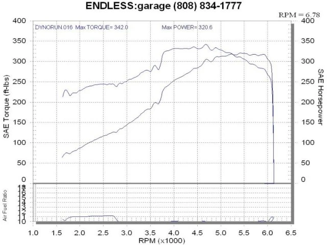

here was my dyno....kinda rich huh? we also tried running the car at part throttle and the a/f was consistantly in the 11's. maybe the whiteness on the plugs was just on the old spark plugs i changed out. i have yet to check the new ones. but he old ones were in when i had the supercharger on so it dont make sense...

Plugs will run white under normal driving.It has nothing to do with WOT.
A/F is to rich,the bucking is from just that,the car is to rich overall.You need to check all hose connections before the tune is adjusted.It shouldn't be rich under normal driving.If there is a leak after the maf of any kind the car will run rich.
Just curious, but why rich. I would think that unmetered air after the MAF would cause a lean condition. I realize you have seen a lot more of these situations than most of us so I am curious as to what causes it to go the other way...
well at least my problem has been found out.. running rich. i will check for any leaks for air after the maf. i think it runs rich cuz the computer tries to compensate for the unmetered air by adding more fuel...i think.
