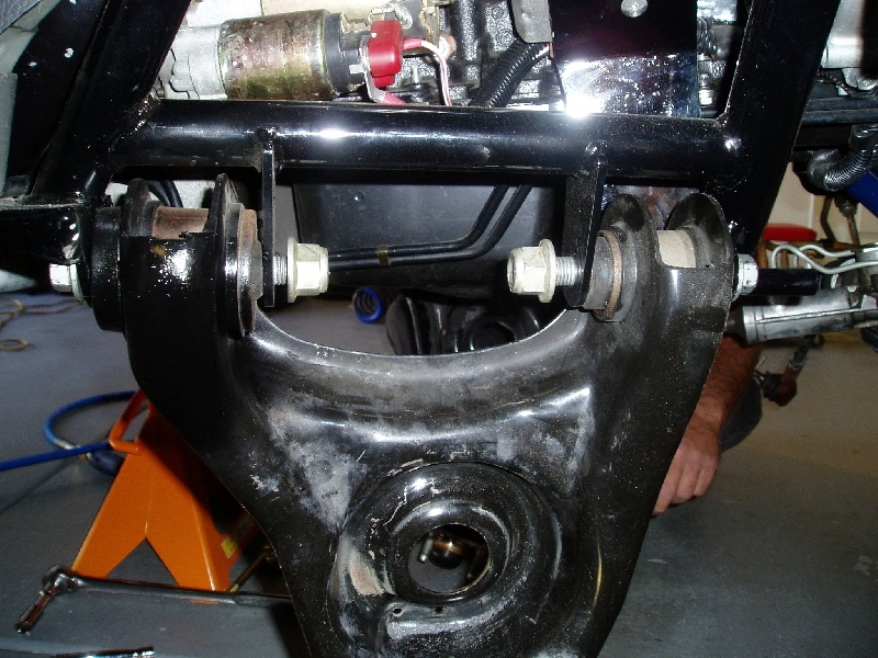

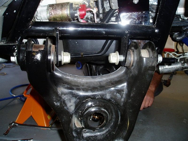

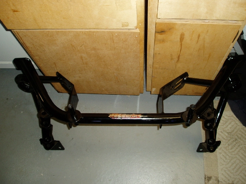

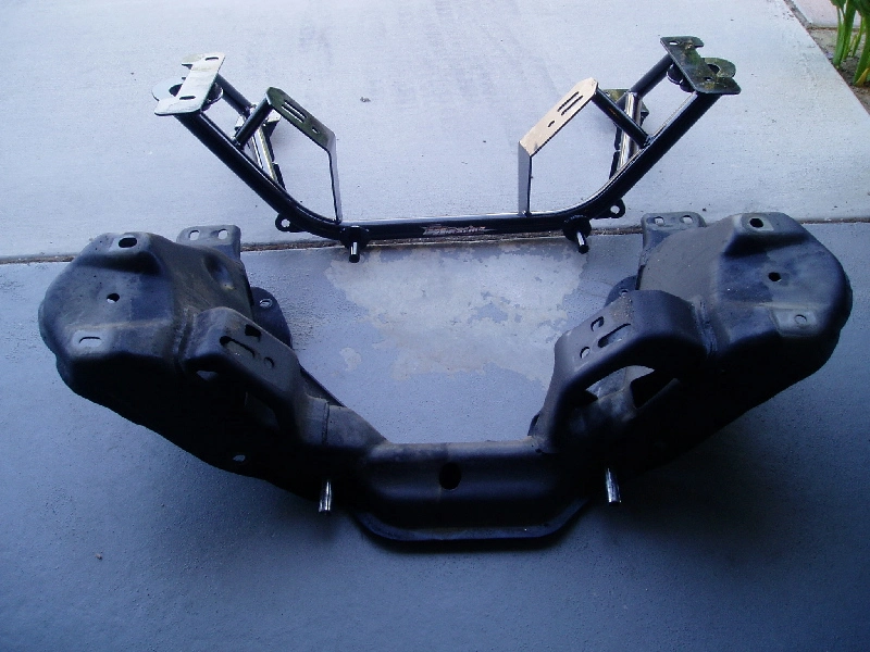

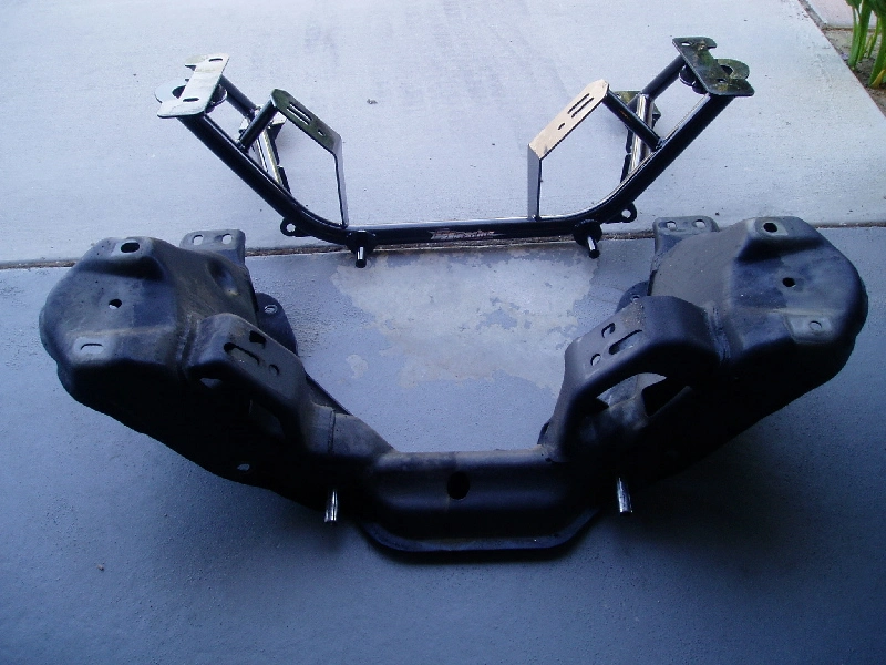

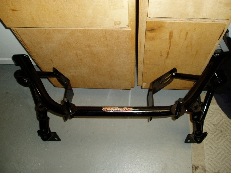

I went with the PA Racing mild steel K and would not change a thing. I also used my stock A-arms. I also had to grind the top of the stock A-arm a little for clearance on the passenger side. DS fit just perfect. I have no regrets with my set-up. Took a lot of weight off the front end.
