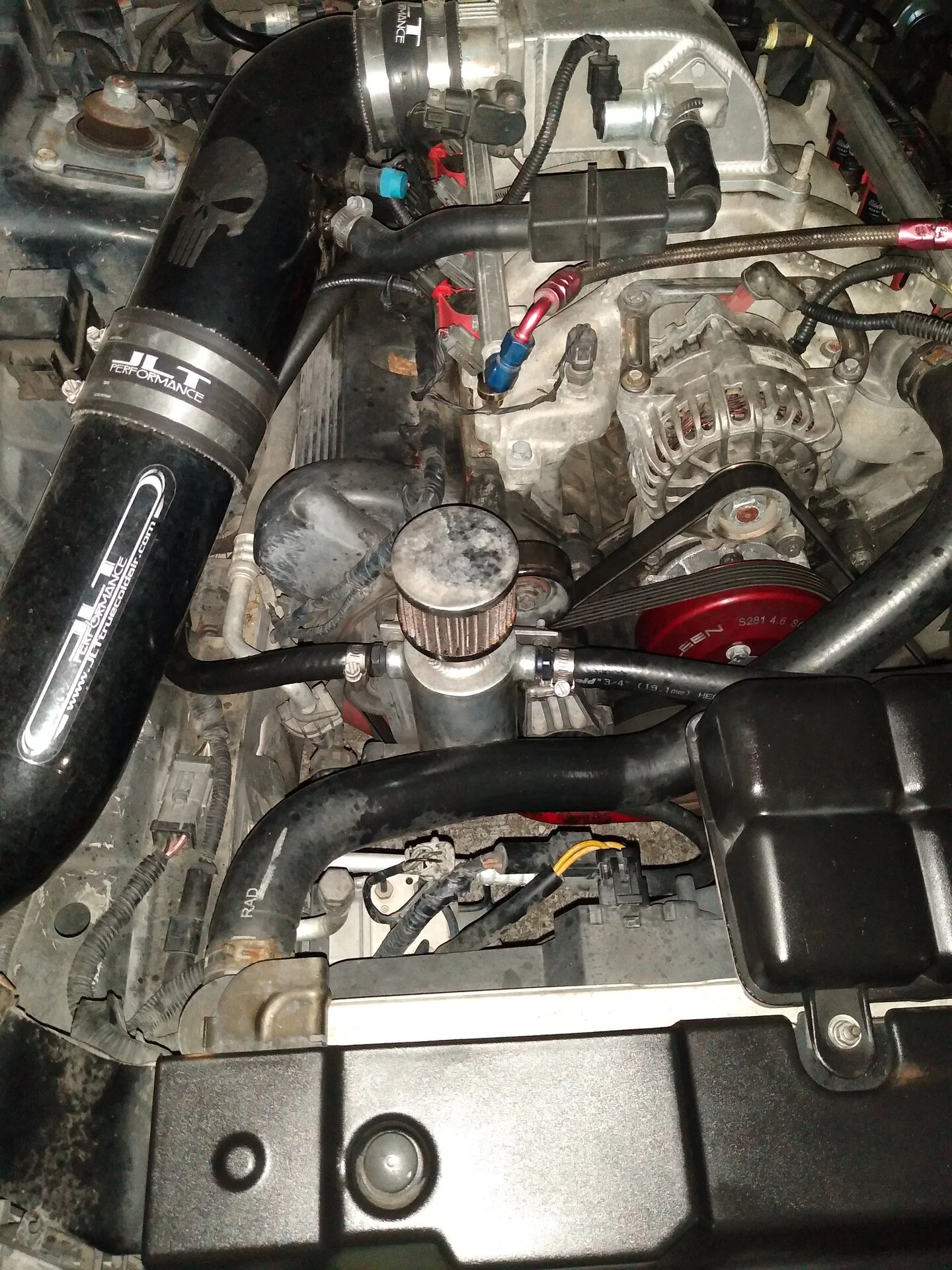

Mine is opposite of yours but this is how mine is set-up. I used heater hose for mine
Interesting. There's a few differences here. So the driver side is a vent tube? My vent tube is a straight up and down valve coming out, where as yours is a 90 degree valve like the PCV.

No PCV valve on mine. It's just a fitting. Yes, the drivers side is a vent. It used to have a valve cover filter on the driver's side. I got oil all over from that so I went with the catch can. The fitting on the driver's side is broken. I've had trouble finding a replacement.

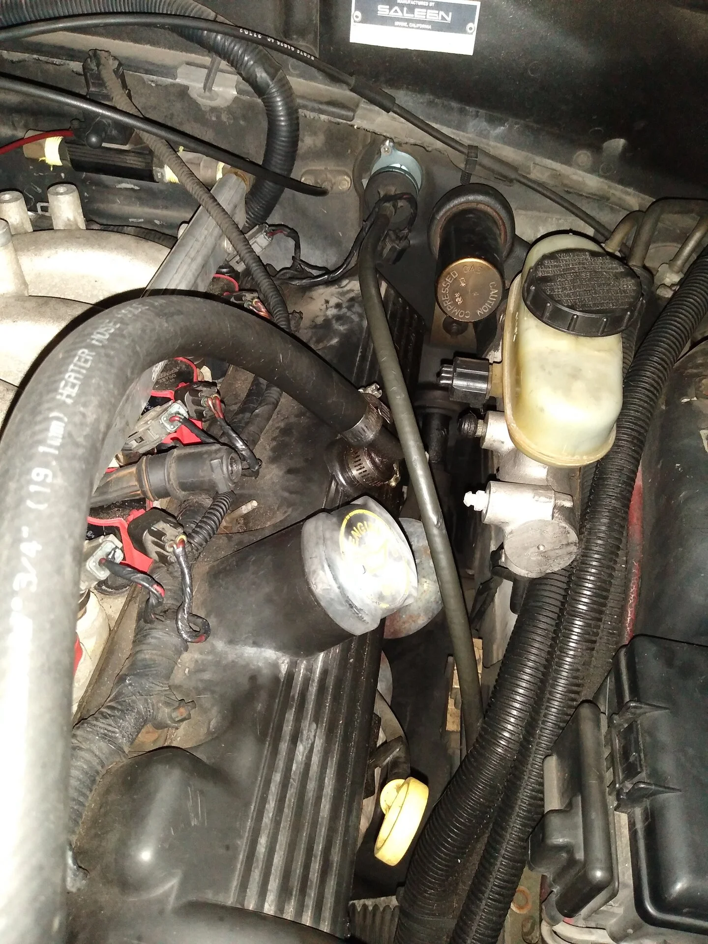

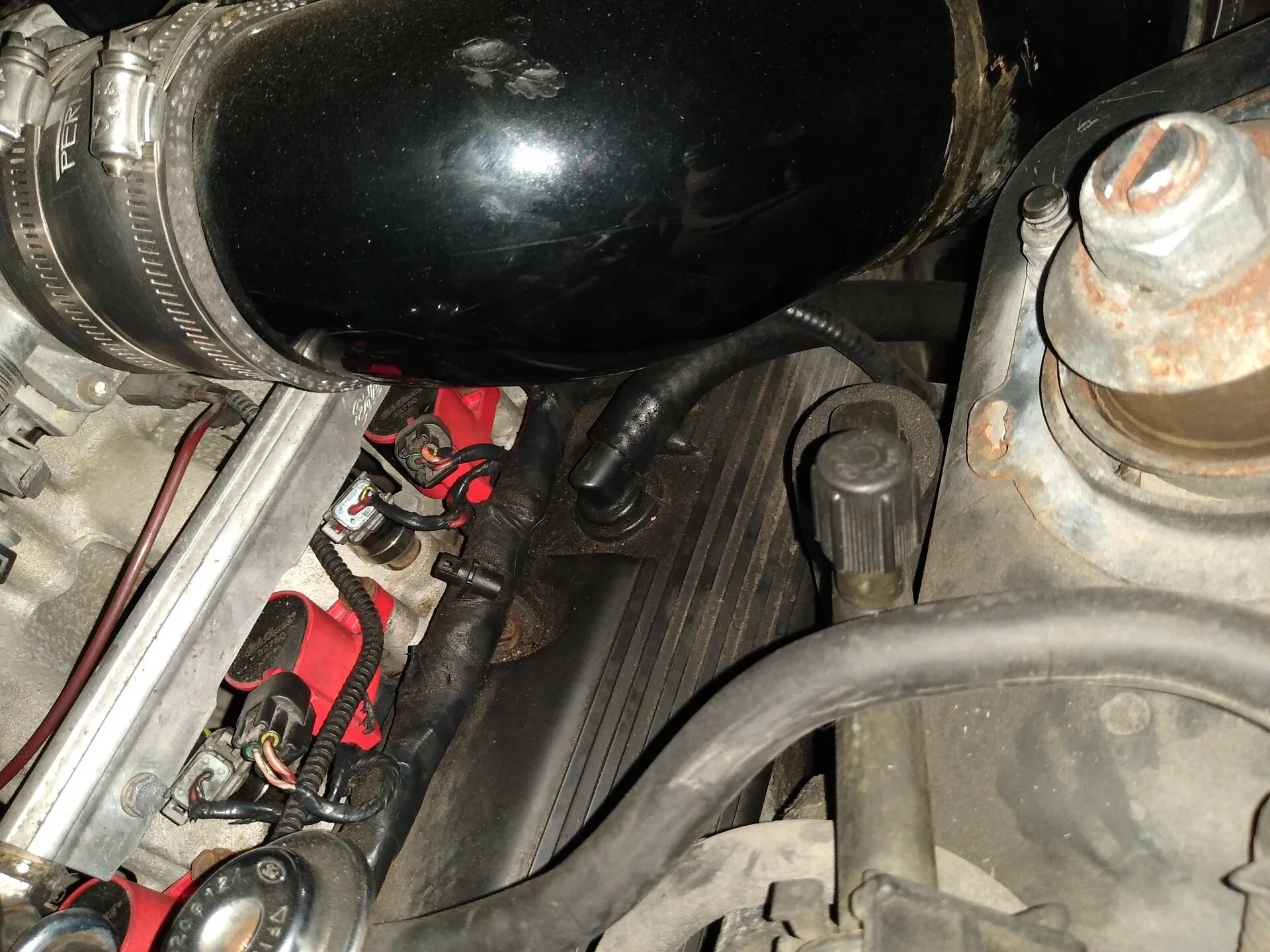

Thanks for the help. One last thing, I went out and took both valves off the car just to get a clear picture. The first one is from the passenger side, what I believe to be the vent tube. Straight up and down. The second and third pictures are of the 90 degree valve that I thought to be PCV, but there is nothing on the inside, it looks just like a regular valve. I’m going to call the shop on Monday to find out, but it looks like pcv might’ve already been deleted entirely and I just need to plug the catchcan into these valves.
