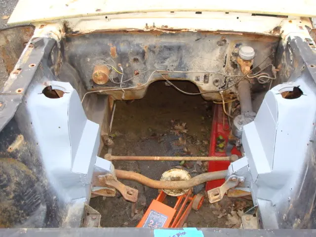

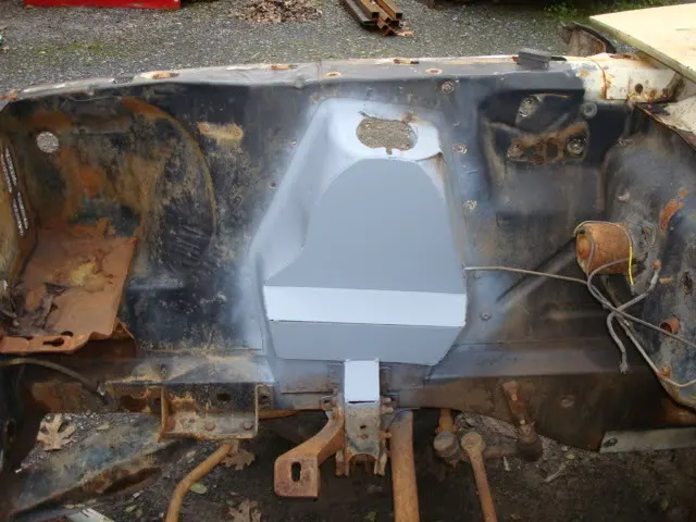

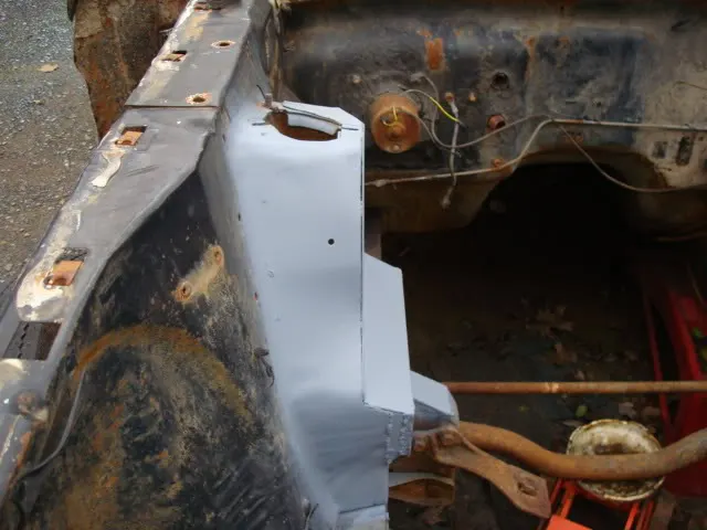

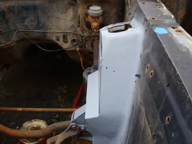

65 shock tower mod
i'm doing a shock tower mod in my 65 vert for a 351W swap! i know it will fit w/o any mods but i like room to work so.....the way i'm doing it with GW uppers will allow me to use all stock style suff and have the room for headers...in fact i should be able to drop the motor in with the headers on...check it out, i dont see any reason why this will not work, i;m welding in 3/16 steel plate witch is alot bigger than stock and i'm able to trim alot away because the orig arms waste room by sitting away from the tower atleast an inch on each side, the GW will sit almost flat on the mounting plate.. when i install the motor i will post pics...Jim
i'll take better pics when the motor is in, this also allows more room between the master/tower.

  • Jan 19, 2011
  • #11
Well, i did the same mod on my 65. But the problem is, the part where the upper control arms mount is actually where the headers run. Now, i had after market heads with higher exhaust ports, and 1 7/8th headers, which did not help at all. But when i dropped my motor in, there was no way to have both headers on. I was able to put the drivers side on, then slide the pass side from under the car. with the motor jacked to one side. both headers were touching the engine bay on both sides when i had everything in. So i had to massage things. After all the problems i had with fitment, i would never tell anyone to do a 351 swap without a MII front end, unless you have a stock 351 with small headers. But, my car could just be special. Because i have seen others with the exact same setup as me. Still SUPER tight, but not the issues i had. But, lets be real. these cars were not exactly rocketship precission when they were made.

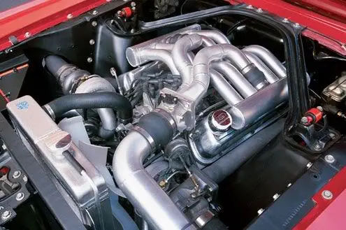

I just found this article with someone running Log Style manifolds on a 65 fastback. hes running a twin setup. I know Log manifolds are less efficient but I would like to hear peoples oppinions. Thanks!
This car is making 525rwhp and over 600ft/lbs
