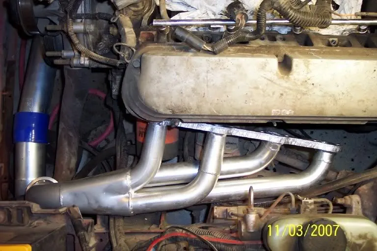

I got pretty far today moching everything up, put the drivers side turbo header is not even close to fitting, so looks like I'll have to send it back.
This pic was taken with my phone, I'm wait for the bigger ones in my email, I'll post them up later.

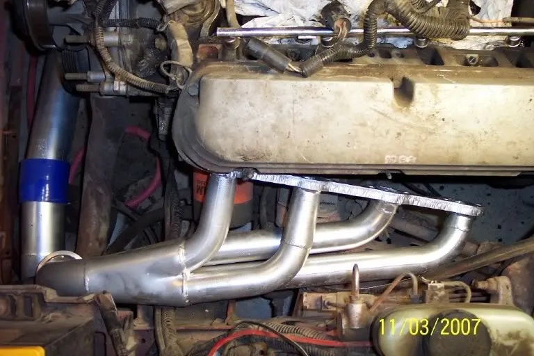

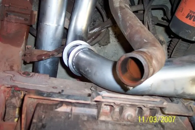

heres some pics, The drivers side header just needs to be tucked into the motor more. It's hitting the frame-rail before the header flang is flat on the head. I sent both headers and the cross pipe back today to be fixed.
Looks like the dyno day out for me.
Matt
