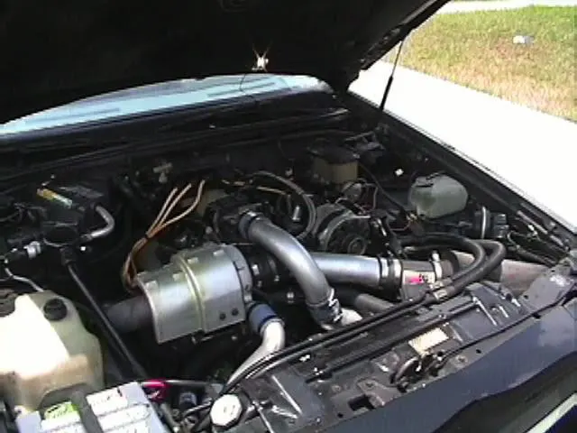

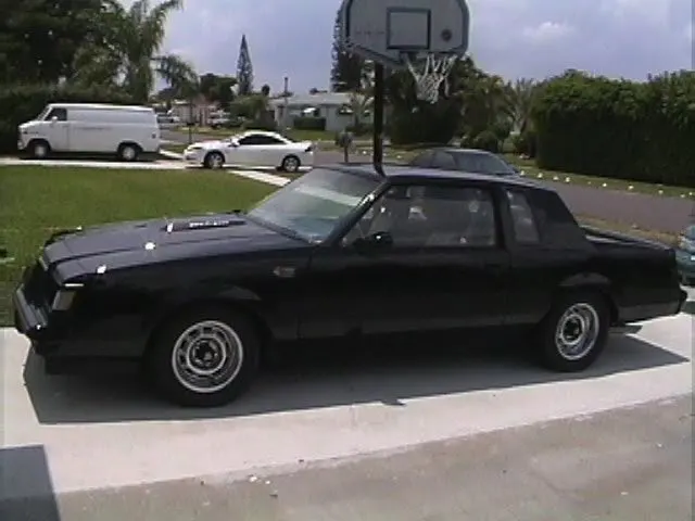

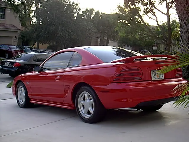

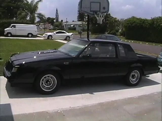

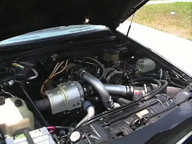

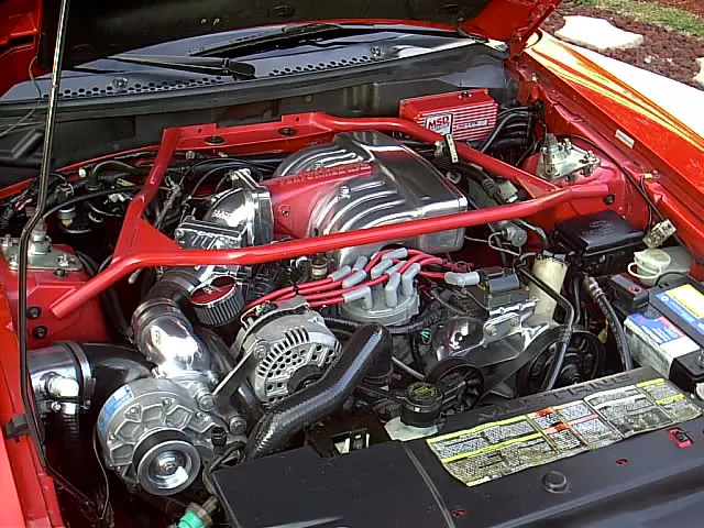

Sleeper 94GT, 302, GT40X Heads, Edelbrock RPM Intake, Crower Cam, Vortech V-2, 12psi, 455HP.
1986 Buick Grand National Regal 3.8L TE44, 21psi, 505HP
