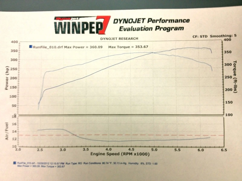

His dyno session is complete. He's on the way back to show the numbers. This is a 2004GT with basic bolt on's. Basically it's a stock 4.6L with Vortech making 7psi, exhaust and a tune. First run it went lean at 4800rpm and he backed out, like 351HP. Let you know how Thunder did in about an hour when he arrives to work.
Sorry to the OP about the thread hijack. Here is the Dyno numbers. He has a Lincoln Aviator fuel pump and I don't think this pump is as good as they say because look at the Air / Fuel Ratio. He's going to swap it over to the Cobra twin pump. He's got 39lb injectors which is plenty. He's seeing around 8psi. Overall he's happy as this is a daily driver and light tune.
How about his MAF? If it pegs it will go lean as well. That's what mine did so I had to use a MAFia on it.
And WTF is up with dyno shots using the STD correction factor instead of SAE? My tuner did the same thing during my last visit.
He's got the Cobra MAF and Injectors. The only thing that isn't Cobra is the fuel pump. Looks like it's that Aviator fuel pump that's the issue.
