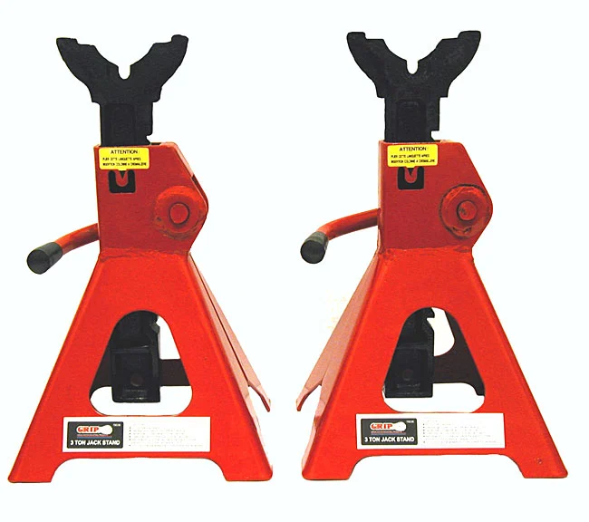

In order to own these vehicles you better have some knowledge with wrenching, electrical know how and like @mikestang63 suggested a good pair of jack stands and a garage to store the car in while it's on them. Pretty much any nearly 30 y/o vehicle will require this kind of preparation, $$ and patience.
