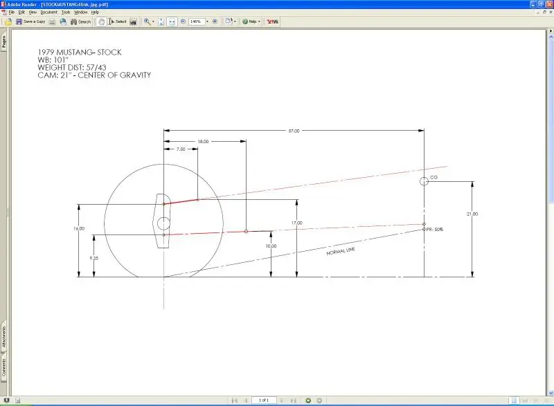

DNA DOA said:
Thats what I thought! My best 60' time is like 1.79. I run slicks, have aftermarket adjustable control arms but don't know what to do about making it hook harder. Need more seat time and knowledge on rear suspenion setup. Once my car lift get here I will start to play with adjustments and take notes.
Thanks everyone.
To get your car to hook better you need to fix the geometry issues that our 4 link rears have. Drag springs/shocks can only go so far. The instant center of the fox 4 link is actually behind the car!
You can spend a lot of money on things like kits from team Z motor sports and such or DIY. If fabbing is your game, you can make aniti squat brackets ala William Mathis and/or change the angle of the upper control arm by welding a new mount lower in the car. If you want cost effective bolt ons those jegster UCA relocaters look good (never used them so I can’t really say), as do those megabite rear LCA (essentially the same as an aniti squat bracket).
If you want it to handle well too you can always do the torque arm panard bar thing… and I think evolution motorsports is hawking a three link these days…
