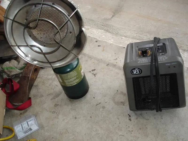

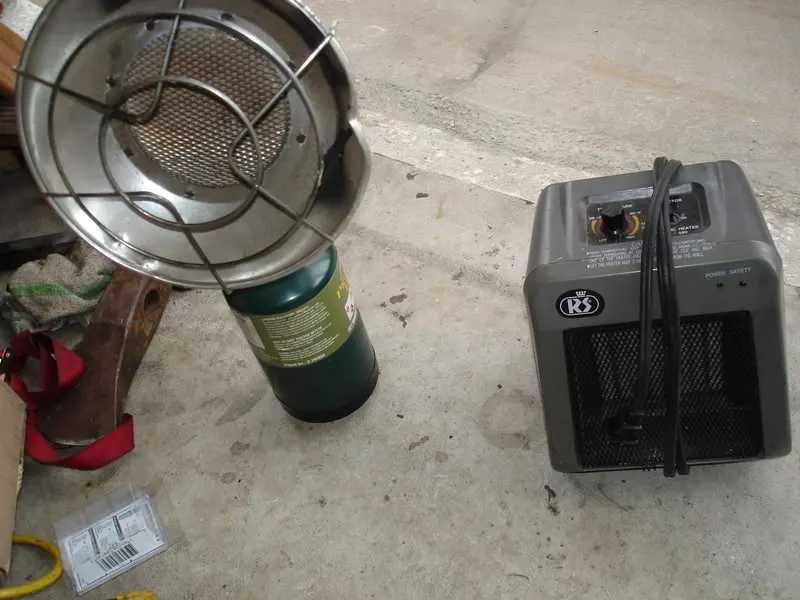

You send me a heater and I'll send you my write up on how to do gears in 2 hrs insteda a month.
Sound like a deal?
Actually we hit a record last night, coldest temp in 30 years seriously, my pipes even froze had no water this morning.
Still no pics...just some busted spider gears anyways.
Pick one
:D :D :D :nice: :SNSign:
