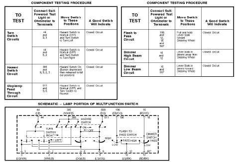

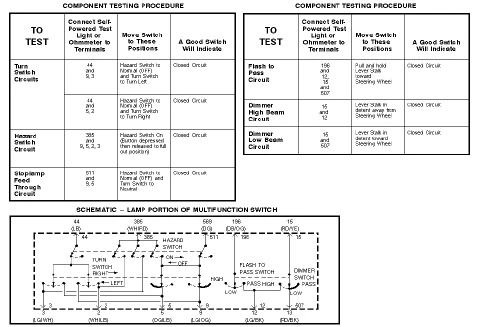

Thanks for the diagrams, kinda hard to read though - if you have any in higher resolution - can you e-mail them to me?

Is there any way you can send me an e-mail with higher resolution format for those photo's I cannot read the one with the testing information. Is the one in the photo B the multifunction switch? Excuse my ignorance with this, I'm not savvy with these electronics...
I can't read the photo - But do I test this with the car in the 'on' position?

ok the multifuntion switch is A in that pic. you can save the pics i posted to your computer by right clicking on them. then you can blow them up with whatever you use to veiw them. I will email you the pics too. ok.
