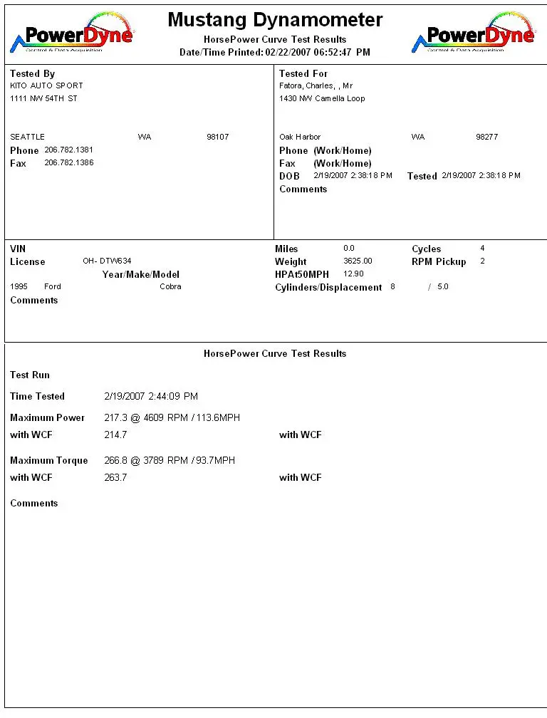

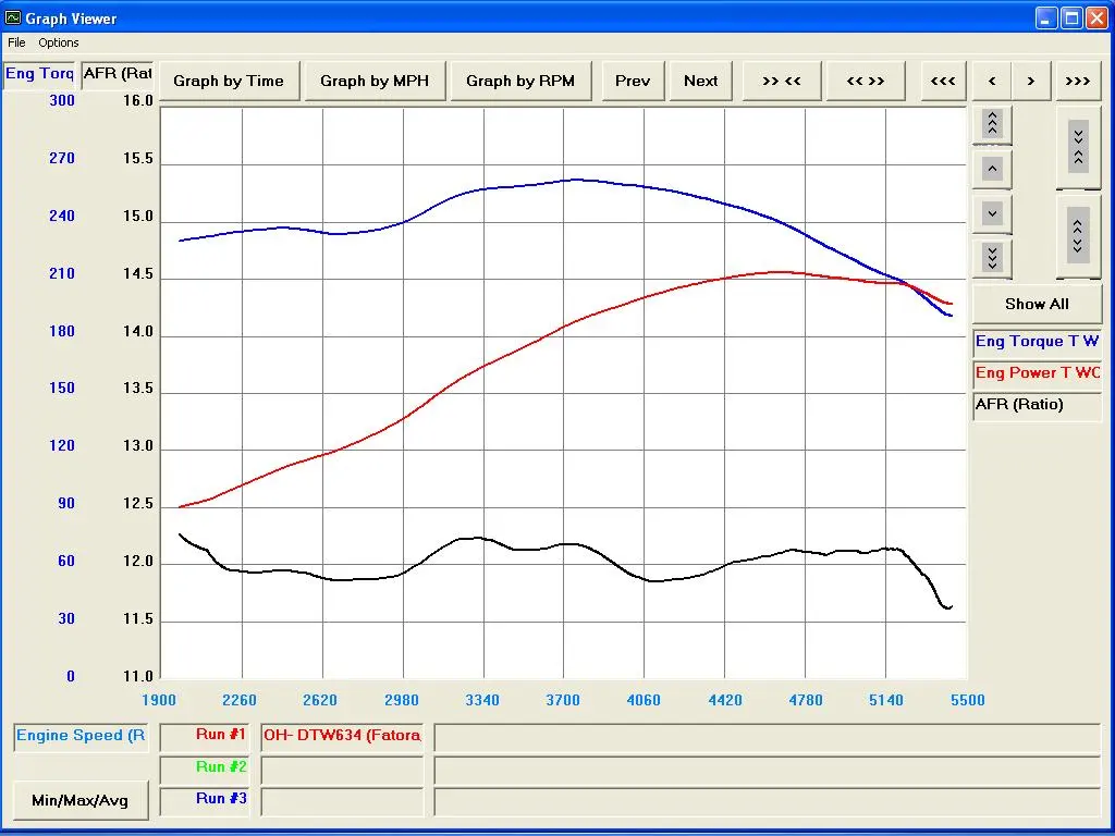

Thanks everyone so far, this is great information. I will let you know where I am leaning. As far as the timing, not sure what I need to set it to. I took my car to a dyno and the tech let me know some areas to pay attention to. I have attached my dyno results. He also suggested that I work on getting a better radiator/fan combo since we were only able to do two runs.
