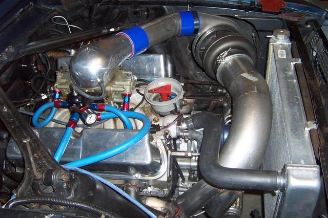

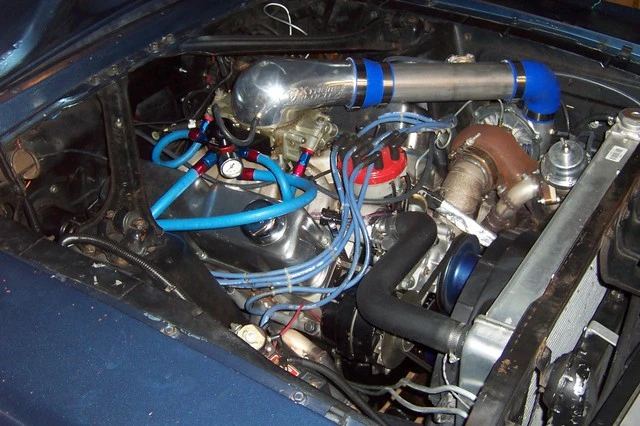

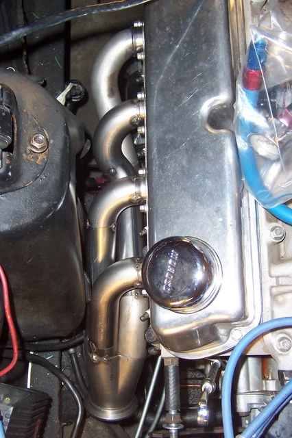

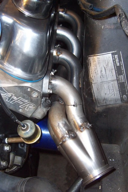

Send 10secgoal a PM here on the forum. His shop lives and breathes turbo smallblock Fords. He makes the nicest turbo headers I've seen so far, perfect welding. They have done a number of blow through carb and EFI cars.
Your 450rwhp goal is not a real challenge for a turbo so a single should do just fine, even w/o intercooler. The block could be an issue depending on how much you race it. 10secgoal and his partner (12sec67) ran a stock block 347 at 575rwhp for a while I think.

A 351 is a tight fit, but it does fit. Sometimes I wish I did twins. It can even be done by an amateur. I think Dustin has done that combo before. Is he doing your headers? If you go diy I might have a few pointers for you.

An F4TE block is more affordable than a Dart. You can build a 351W shortblock with H-beams and forged pistons for around the same money as an empty Dart block. That was my reason for building a 351w. My motor is easy to work on, but the headers are much tougher to build.
