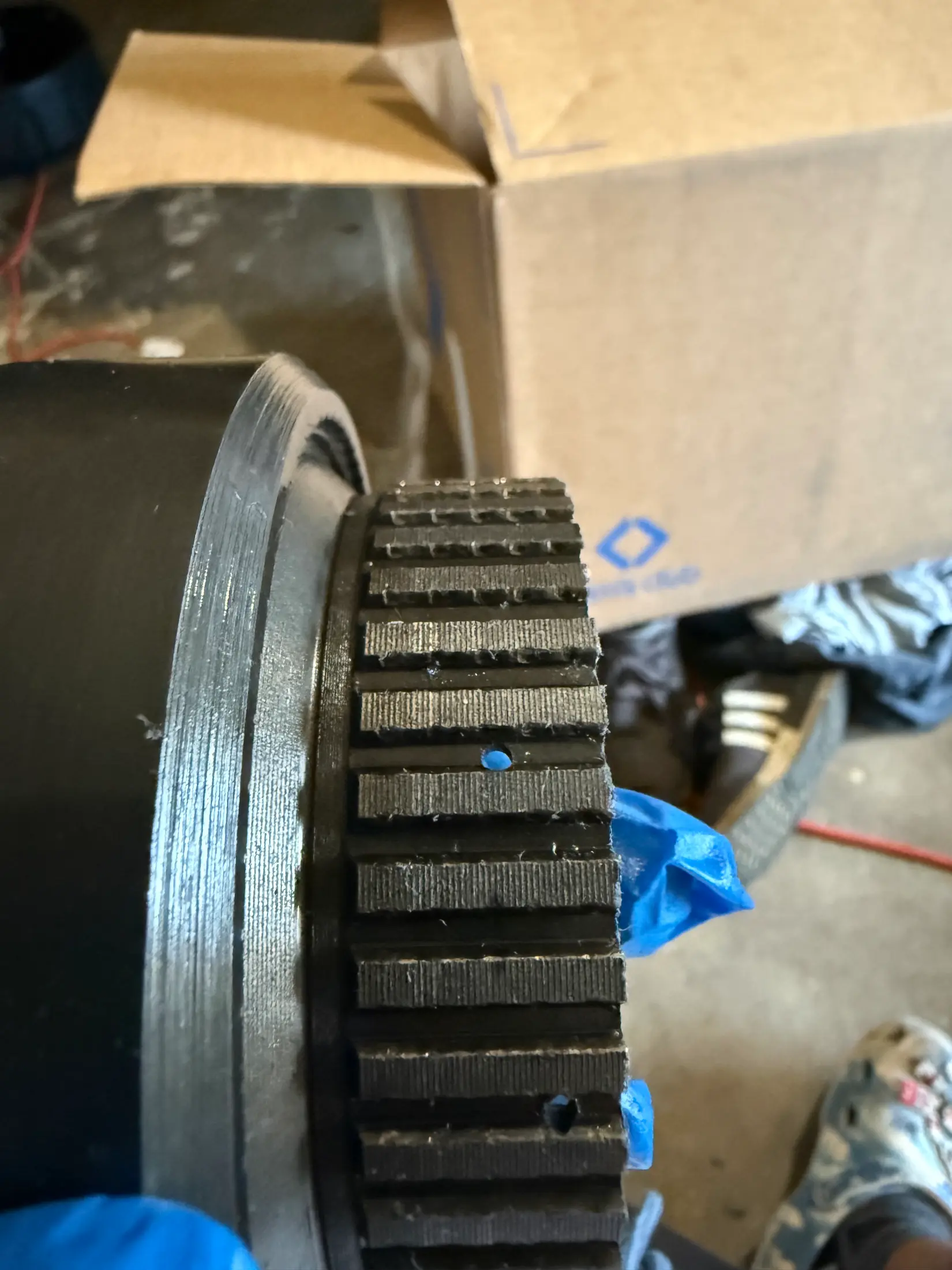

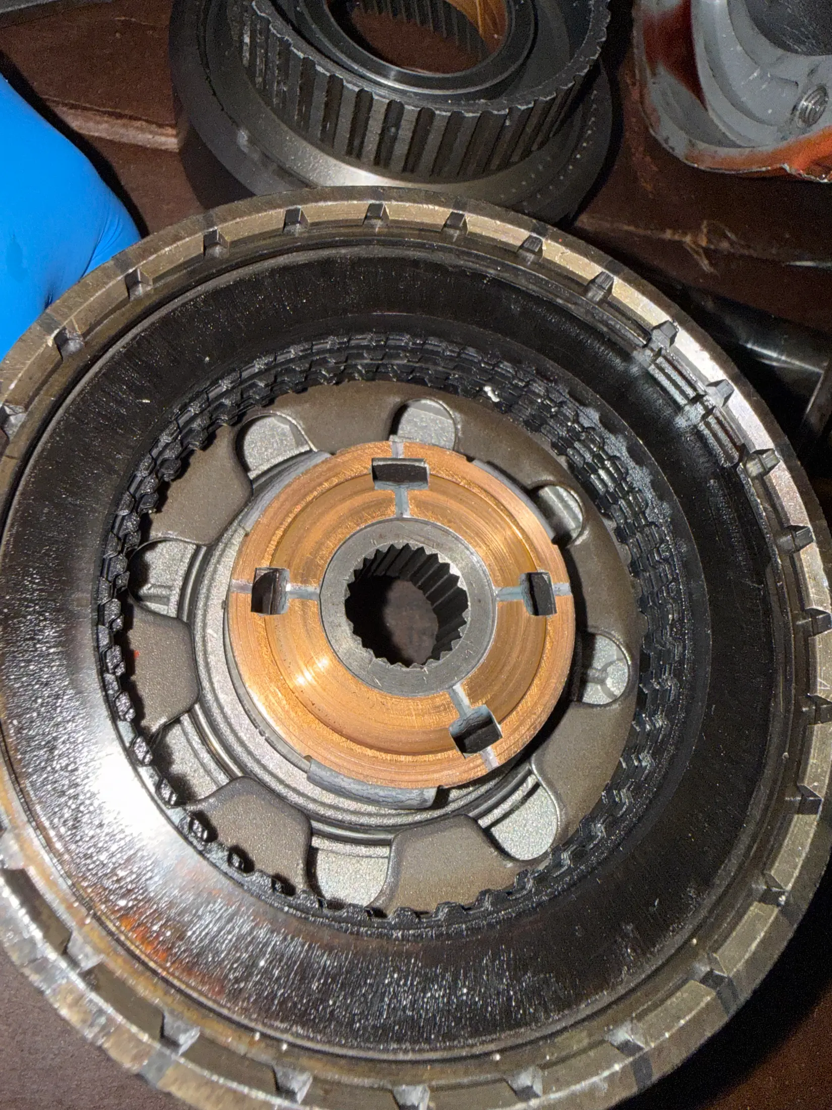

So I got the tranny dropped this weekend opened it up the band was really loose and the ring gear hub was stuck in the forward drum and some the steels were really chewed up. It also created some grooves in the ring gear hub.
