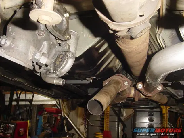

ok guys an update. I just took some pics:

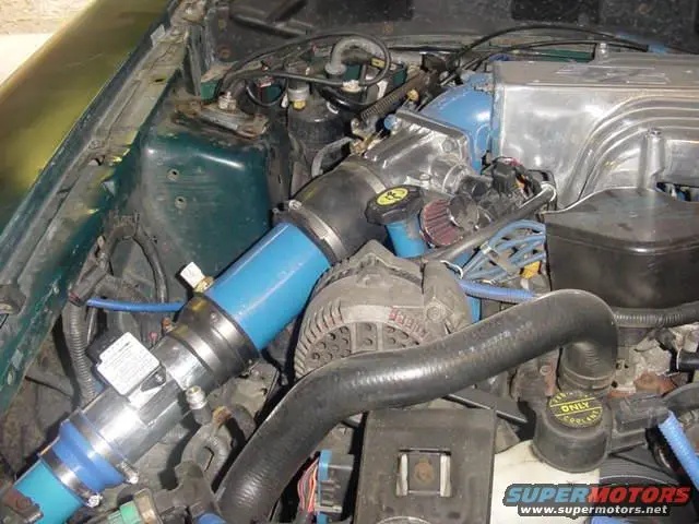

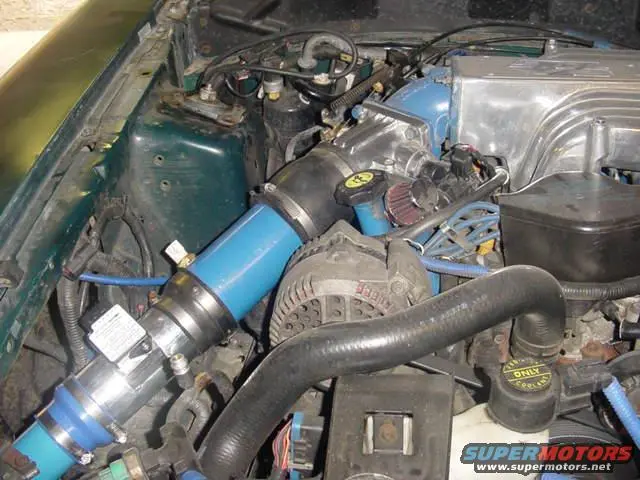

here is the Engine bay basically how it will look when im done....lol it looks just like i got a cold air kit on it.

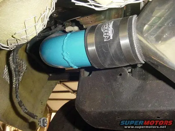

Here is the intake tube coming down the pass side fender area into the intercooler
Here is the Intercooler mounted..dont mind the car's paint. Its getting a coat of DSG when im done.....The intercooler fits perfect in the opening of the saleen spoiler....it looks badass IMO.

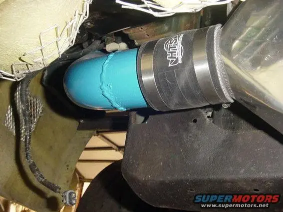

Here is the Intake piping the runs from the intercooler, over the driver;s side tire area and down the wheel whell to under tha rocker area

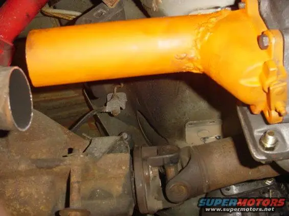

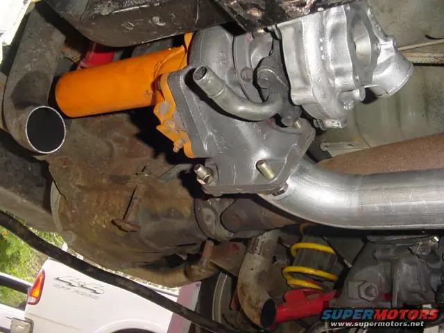

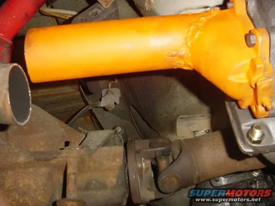

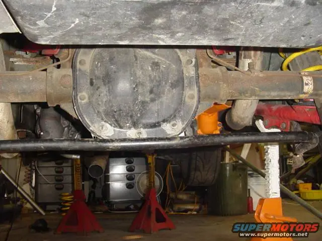

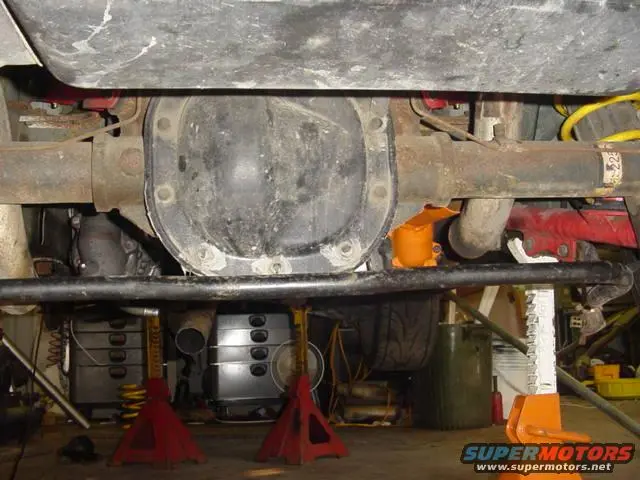

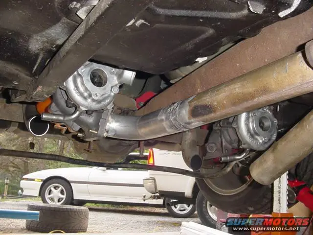

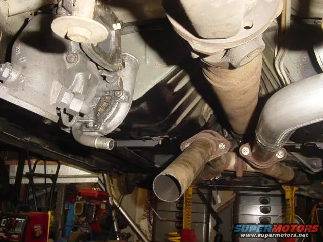

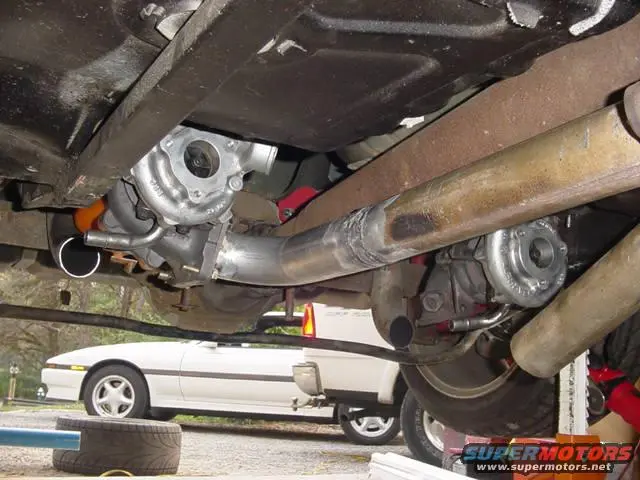

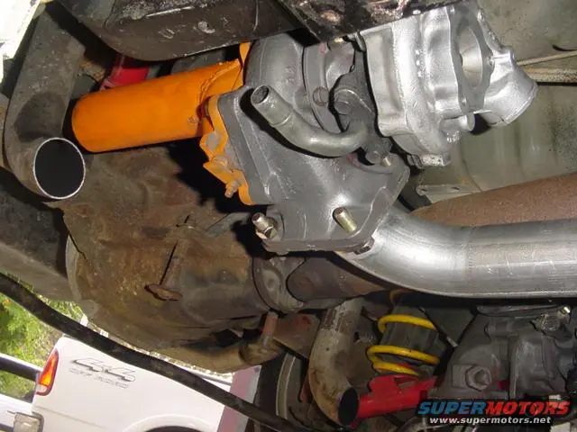

Here are just some random pics of the twins....the pass side is mostly mocked up, the driver's side still needs to have the waste-gate housing modified like i did to the driver's. I showed a pic of how the system really dosent hang down too much at all.
anyway...right now ill be working on getting the exhaust inlet to the driver's side, and welding up the wastegate housing.

hey since you have water cooled turbos. DId you think about putting in a water tank in the trunk, and runnin a pump to feed the turbos with water.. THen just fill it up with ice water at the track. WOuldnt be practical for street driving, but i bet it would drop ur inlet temps alot with the ice

Man i have to give you Props, you are doing one of the most original turbos i have seen on anything. In the pic, i like how they don't sit any lower than mufflers on my car do....
One question i came up with is, your cold side piping is gonna be where? On top of the exhaust, or what, and are you gonna have any clearance issues once the suspension is loaded up again... Not doubting you in any way just trying to educate myself.... good luck and great job so far...
jason
whell, im still figuring out the cold side. what i think im gonna do is have the pass side go straight up into the rear seat area, cross over, then come down, merge, then meet that blue 2/1/2 pipe along the side skirt area...more pics coming...

However, I was thinking of doing a single setup instead of a twin. STS Turbo Systems is the company that does remote turbos and their site says that an intercooler is not required since the intake charge cools through the extended piping from the back to the front. So, back to my main question, would this setup work with a single, let say, T4?

whell, i know sts says you dont need an i/c, but i wanted to run a small one anyway, a pipe cant cool off that much. Next, the reason i did twin is because its easier. The stang has a dual exhaust. You could do a single, say like a MP t-70 or somethin with a real small a/r. but then you run into having the crossover tube near the axle, if you mount it where i mounted mine.
