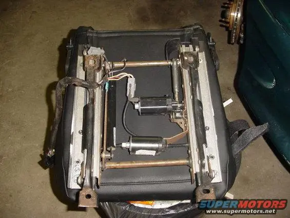

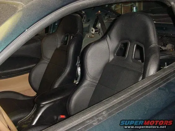

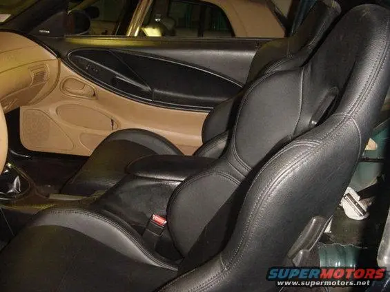

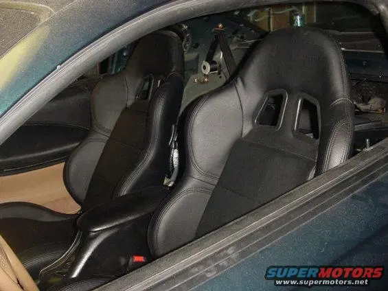

thanks guys....i will try to weigh the seats, but mounting them is gonna be an issue. Ive been working on the pass side, and i will be cutting the mounting brackets off teh stock sliders and welding them to the sliders the seats came with.
The drivers seat looks really really easy, as i will just have to drill a couple of holes, as the power seat is a diffrent mount. As a plus, i will retain my power seat and it will look cool!
Also, yes they do flip forward, there is a lever right at about neck level on both sides.

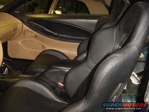

Whell, i finally finished my seats and my pedals! The seats came out great, and best of all, i was able to retain my power drivers seat mount!
Also, my turbos will arrive monday, so it starts then!

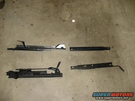

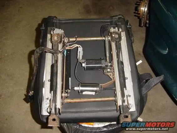

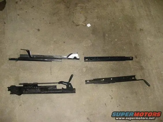

here are the seat sliders that came with the jeg's seats, and here is what i had to do to modify them...i had to cut the brackets off the stock sliders, and weld em to a angle iorn, then to the jeg's sliders.
The driver's seat was easy, i just drilled 4 new holes in the power seat slider, and bolted it up!

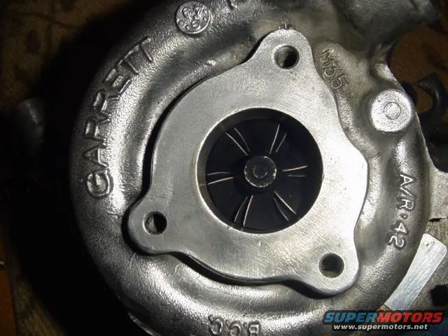

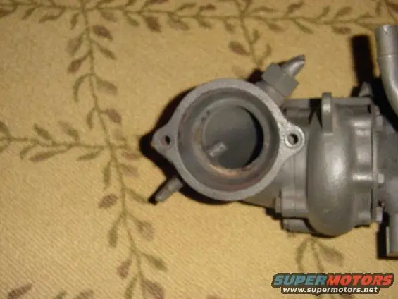

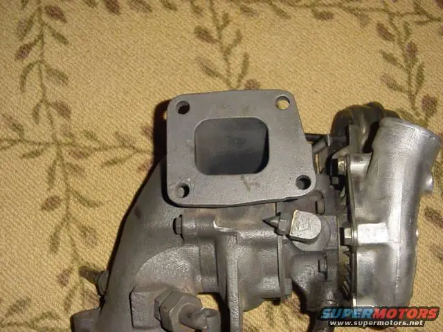

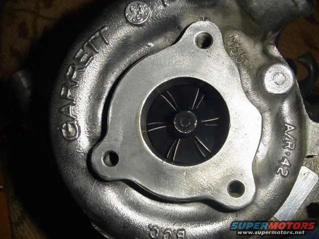

Whell guys, i got my used t3's today.
Garrett model number: TB0335 (T3 series turbo)
Compressor Trim: 50
Compressor housing A/R: .42
Turbine Trim: 69
Turbine housing A/R: .48
Horsepower Capabilities: ~275hp
Internal Wastegate: Yes
Water cooled: Yes
Wastegate setting: 7 psi

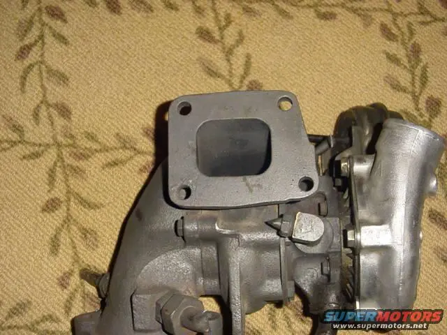

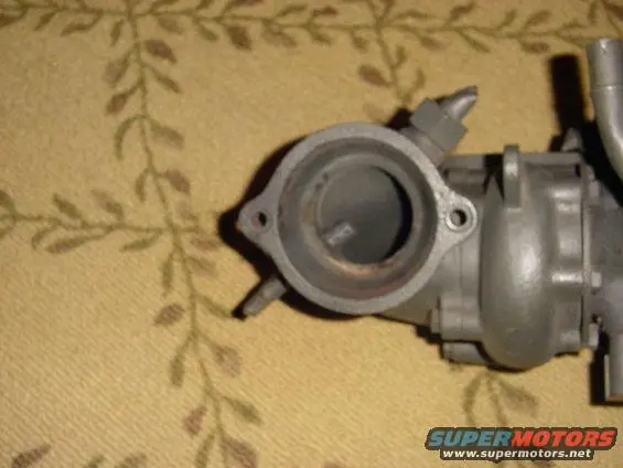

However i have a few problems. i ordered some 4 bolt t-3 flanges off ebay, and they dont fit. Can you guys tell me where i can find flanges for my Inlet, Outlet, and Coldside Inlet? here are the pics.
