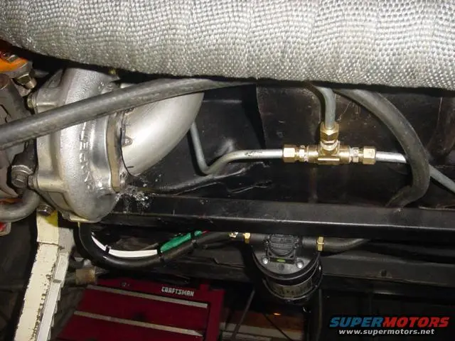

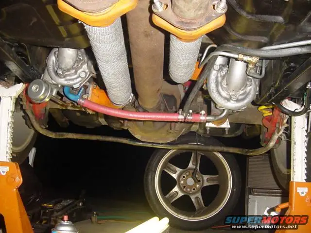

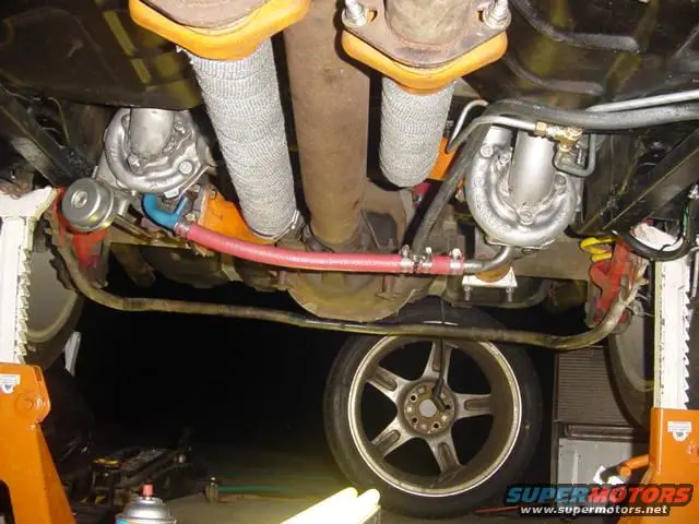

Here is the system how it stands now, i completed the hot, the oil, and just need to finish the inlets and outlets on the cold

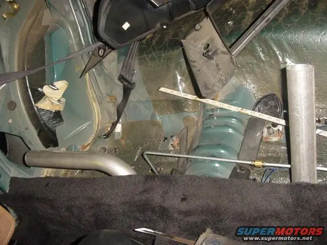

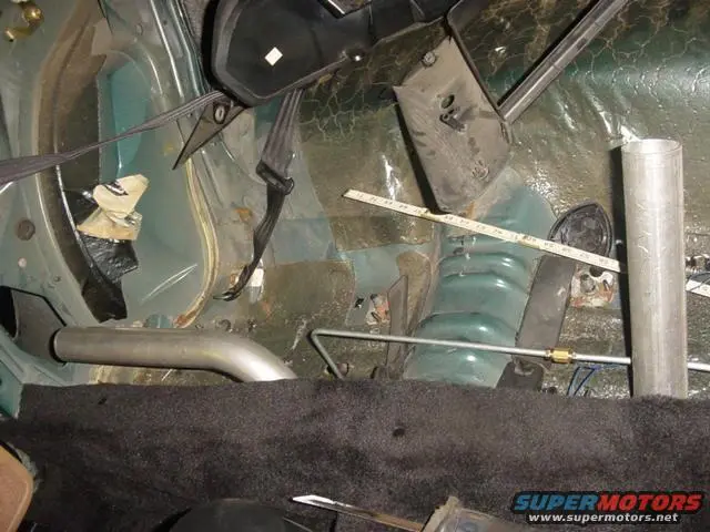

Here is the blue 2.5" tube from the intercooler...driver's side fender
This is the rear seat area....you can see the oil line, and the beginning of the inlet tube from the side vent(i also got my zenon side scoops today...lotsa room now)

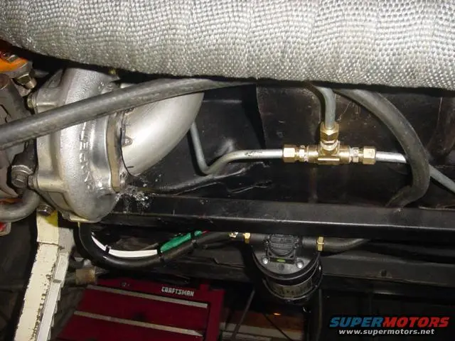

Here are some random pics of the oiling system
Tilton pump mounted on the driver's side
Turbo oil dump with vent
oil press sender i re-located to the side of the oil pan
