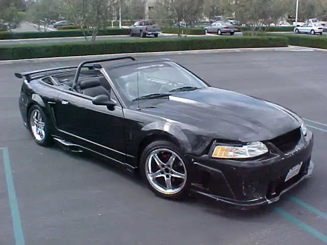

she had a little run in with some punks.. heheh no sweet should be all done in 2 weeks..
