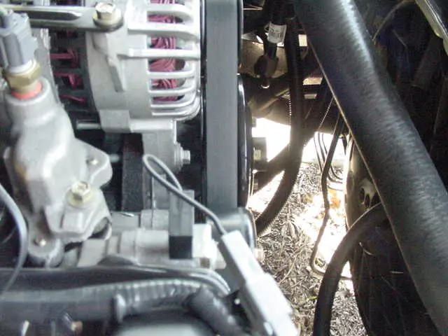

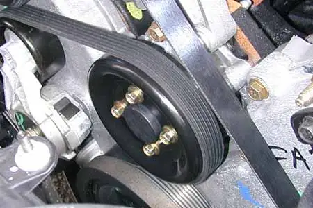

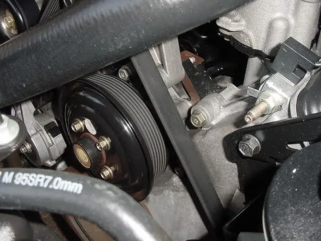

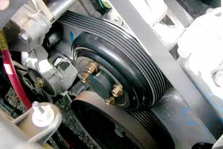

Thanks for the replies all unfortunately, I’m still a bit confused and need some further help. At the Steeda site they mention the water pump change took place at two different times, unless I’m just not reading the information right. Below I pulled the text off the site and it mentions the change took place Mid-way through the production run for the 2002 model year Ford, supposedly it occurred in January of 2002. Then below the pictures on the site for visual inspection it mentions Mid 2001.
I can’t post pictures inside a thread yet so I’ll have to attach them. If you could take a look at them and help resolve my confusion I’d be thankful. The first two pics are of my pulley and the next two pics are from the web site.

Steeda's Guide to 4.6L Water Pump Pulley identification
1. Mid-way through the production run for the 2002 model year Ford changed the design of the water pump on the 4.6L engine. The older style pump produced from 1996 to mid 2002 had a longer shaft. In January of 2002 the design of the pump was changed to a shorter shaft. This necessitated a change in the design of the pump pulley.
You should visually identify which pulley/pump you have before ordering.
The old water pump pulley had a convex or "bowed-out" face, the new design has a concave or pressed in face. There is no exact changeover date for the pump and pulley. It is important to visually inspect your car to see which design you have. Supposedly the changeover occurred in January of 2002, but we have seen cars with identical January build dates and different water pumps and pulleys. We have also seen the old style pulley use in a few 2002 models, so be sure to check yours before ordering.

My 2002 GT was also built on oct of 2001 and it uses the old style pulleys. 1996-2001 style. If it looks like this:
you need the old style pulleys. I believe ford changed the over Feb 2002.
Use all the pulleys including the alternator. I'm using it since dec of 2001 without any problems. The lights dim a little when the heater fan is on high, that's all.
Thanks ForPointSex, that's exactly what I was thinking... my pulley looks just like the one in the link you posted.
