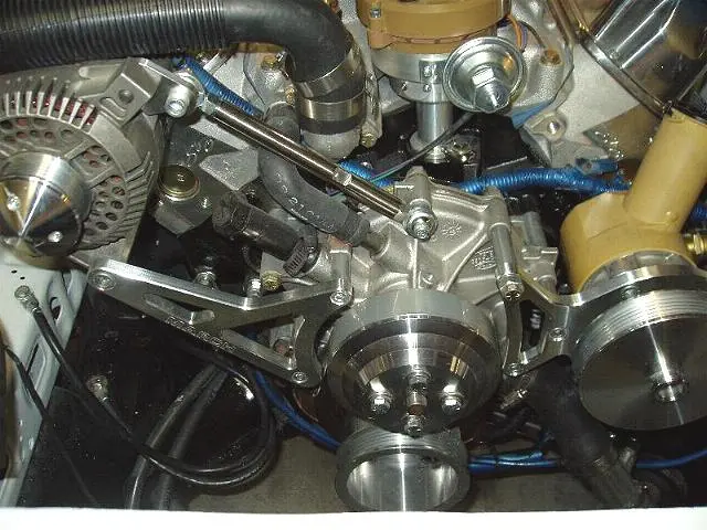

Would anyone know the length of belt needed if I used UD pullies, with a A/C Delete, and wanted to bypass the smog???? ALSO! Could someone show me how the FMS A/C delete kit works??? I dont understang this..i need a pic, THANKS MAV!

My new pullies:
March pullies and brackets, Gates K060670 belt
