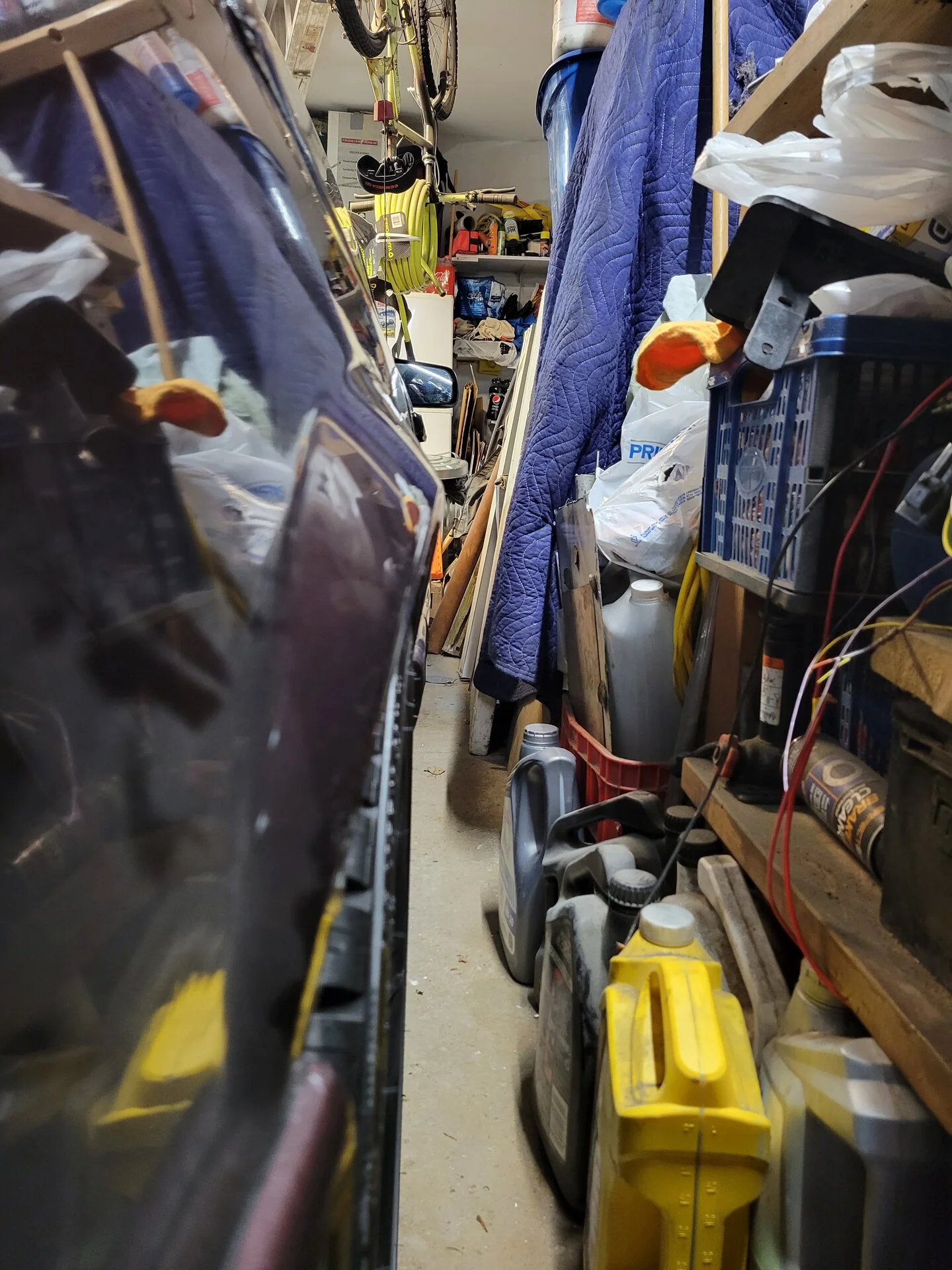

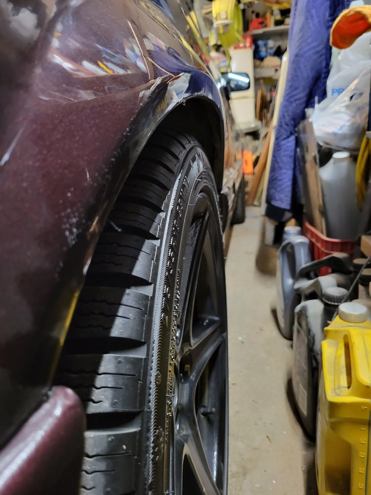

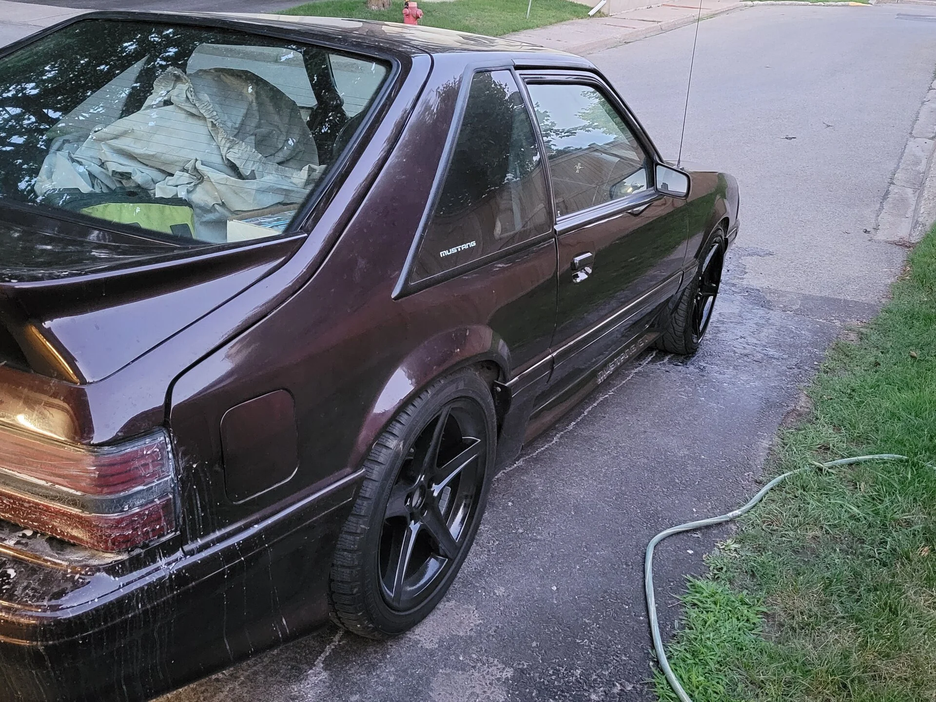

Here is my 18x9 +24mm offset with Fox length axles with a 5/16" spacer (8mm). My wheel opening is rolled (hammered actually prior to body work) and I do not have rubbing.
So lets do some math:
18x10 rim will move outer lip 12mm out.
difference in offset is +4 further out - so far +16mm out from pictured
you won't need the spacer so -8mm - so far +8mm out from picture
longer axles will move +19mm out - so +27mm (1-1/16") further out than pictured.
With Fox axles it should only be +8mm further out.
The SN axles and the rims you want with a +40 - 45 mm offset should fit with +45 being really close to mine as far as outer lip.
