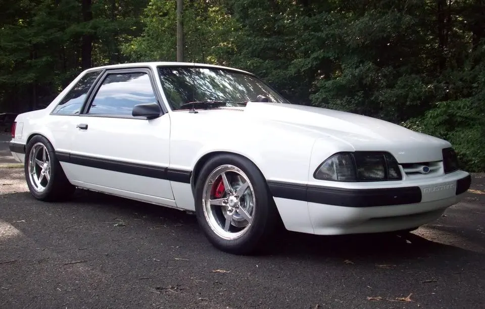

Discuss..
87-93 Ultra Smoked Headlight Kit For Mustang at LRS - Same Day Shipping!

Thats what I will be buying, I love the look

Any one have these on their car now?

Hope you want to see at night.

I don't have those exact ones, but I have some from Blue Oval Industries and no... you cannot see anything at night. LOL

Doh!!! I have a set that I haven't installed yet.
Guess I'll just have to put HID's in my foglights.

Looks before function! Everybody knows that haha. But i hardly ever drive the car at night and i plan to put in HIDS to help the situation!

Those look way to nice to be worried about safety. Seriously though, wonder how Hid's would look in those. I dont like foxes with hid's, but maybe the combination with smoked lights would tone them down to roughly a stock light output.

I ran the regular smoked headlights... had to retrofit hid's to see anything....

The prob is you shouldn't really run a 9004 style headlight without a glare shield in front of the bulb. 9004's are meant to run behind diffuser style lenses that knock down the bulb's intensity a bit.
With ultra clear lenses, the bulb is just hanging out in the open. The SN95's use a 9007 which is the same bulb, but with a glare shield with their clear lense.
So, ultra clear lens + 9004 bulb w/o glare shield + HID's = aircraft landing lights.

Post #17, after seeing these i want! This guy sais he runs regular xenon hyper white bulb and they are brighter than the other somokes he had on his car before.

After seeing those photos of that car i am FOR SURE buying those headlights. It was between those or normal smoked. Thanks!!
