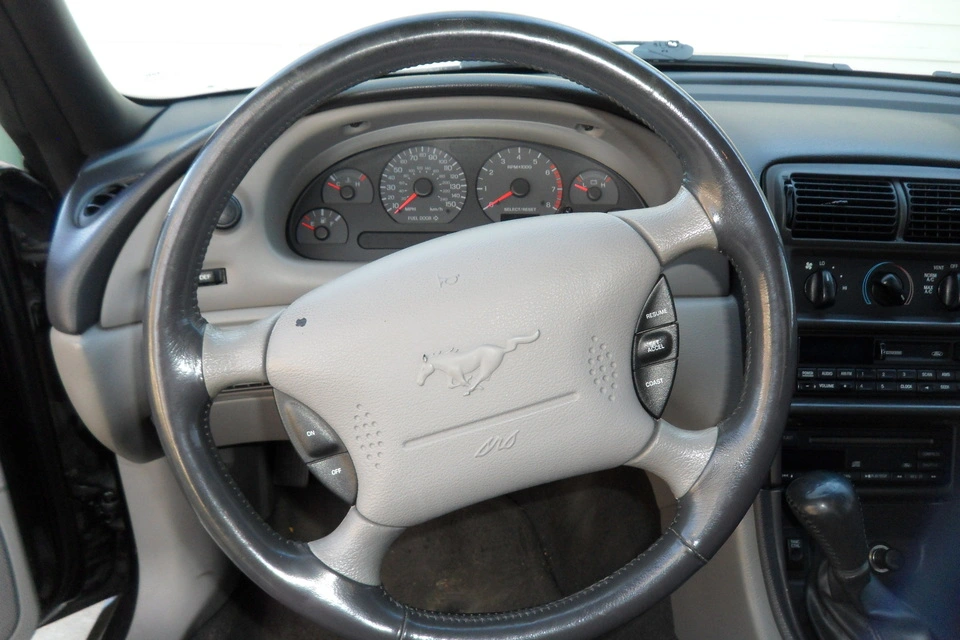

The steering wheel in my '99 GT has recently become uncentered when the car is driving straight. I'm hoping some might have more ideas about what I could check. This is how my steering wheel is positioned now...
This started about 1000 miles after replacing the original rear control arms; don't think this is really a factor. A wheel alignment where the toe was corrected (both wheels at +0.15°) also centered the steering wheel. But 300 miles later the steering wheel returned to being uncentered, yet the car still tracks straight.
Another point is that even with the CC plates, there wasn't enough movement to bring the caster negative to get into spec. But according to J&M that isn't such an issue. I suppose they should be at least the same, which is yet to be the case.
Based on the details below, do some of you have any suggestions for what else I could look at?
