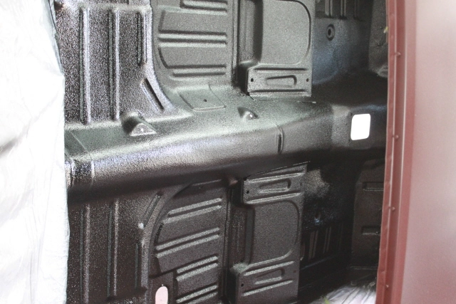

I have tried to blast away the epoxy primer and if it was applied over a blasted surface it is very hard to remove . I did spray bed liner in my 69 inside floor but it is catalyzed and i bet that will be a night mare to remove ,but it sure looked good

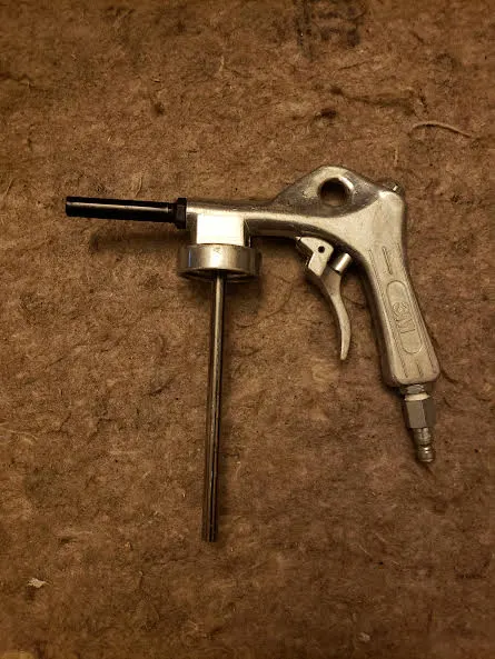

Above is the undercoat gun I use
It fits the cans you can buy from an auto body shop supply and is a 3M brand
Sprayed rocker shultz on the lower section of my Z28 years ago
Spray it yourself 7991LXnSHO
