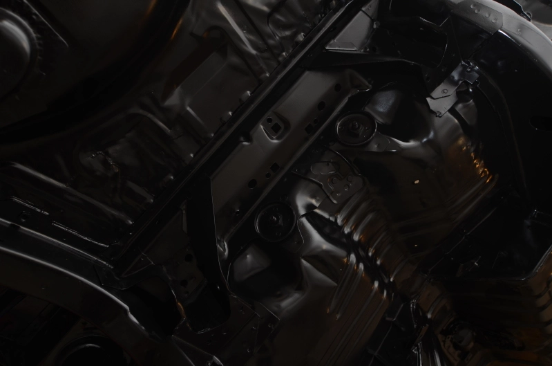

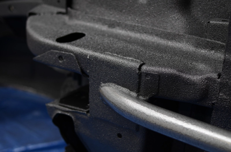

If you do decide to refinish the entire bottom of the car, I had awesome success with Raptor liner. It's a 2k urethane bed liner product that comes with an application gun. You can manipulate the texture by adjusting the gun pressure and spray distance. I really like how it came out on the underside of my car. I sprayed it on extra heavy in the rear wheel wells to take the beating of rocks and road debris.
Or, if you don't want to commit to the whole bed liner thing. Eastwood's Chassis Black creates a very nice and durable finish. Would work fine for a top coat underneath, or just for the spot repairs you want to make.
