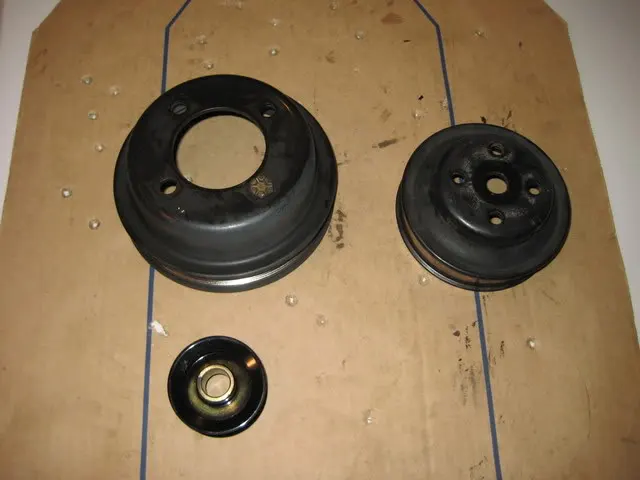

Here is an example of my stockers compared to my Steeda pulley's.
Here are the stock pulley's. (I can't recall if the stock pulley's are black or not, if anyone knows let me know just for educational purposes).

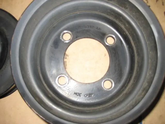

You can see the ford stamp at the bottom

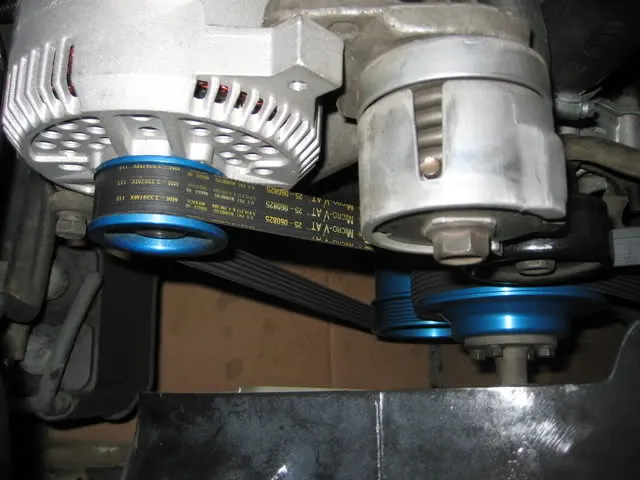

And here is the pulley kit from Steeda
Thx for teh conformation mang. :nice:
However, dont just go by color, because Ive seen black aftermarket pulley kits before. But you can kind of see the difference between teh two.
