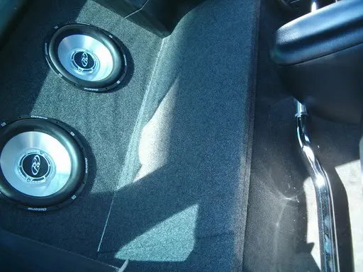

Plus the full Mach460 set up? Total 10 speakers and 5 amps? :Word:
