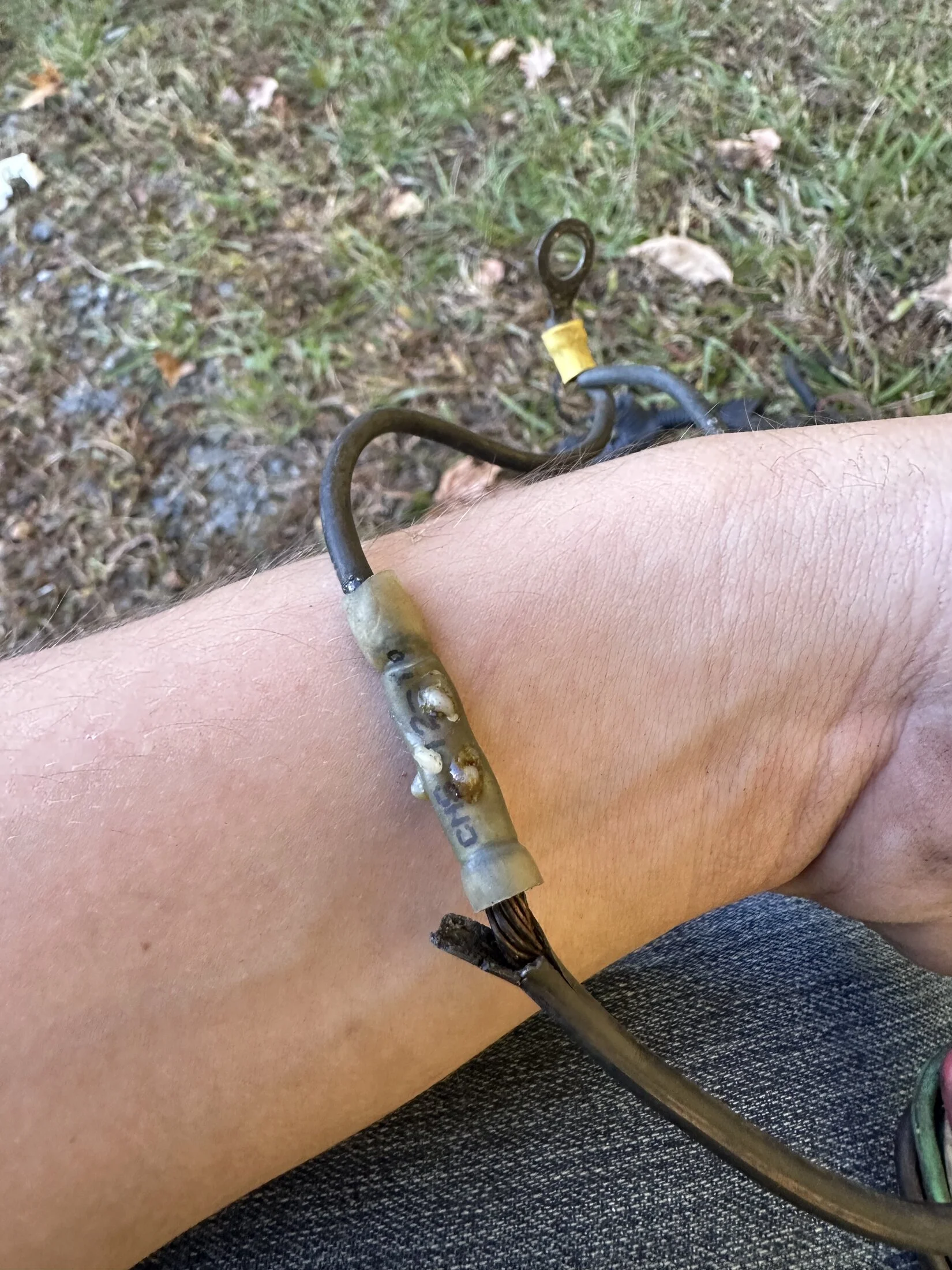

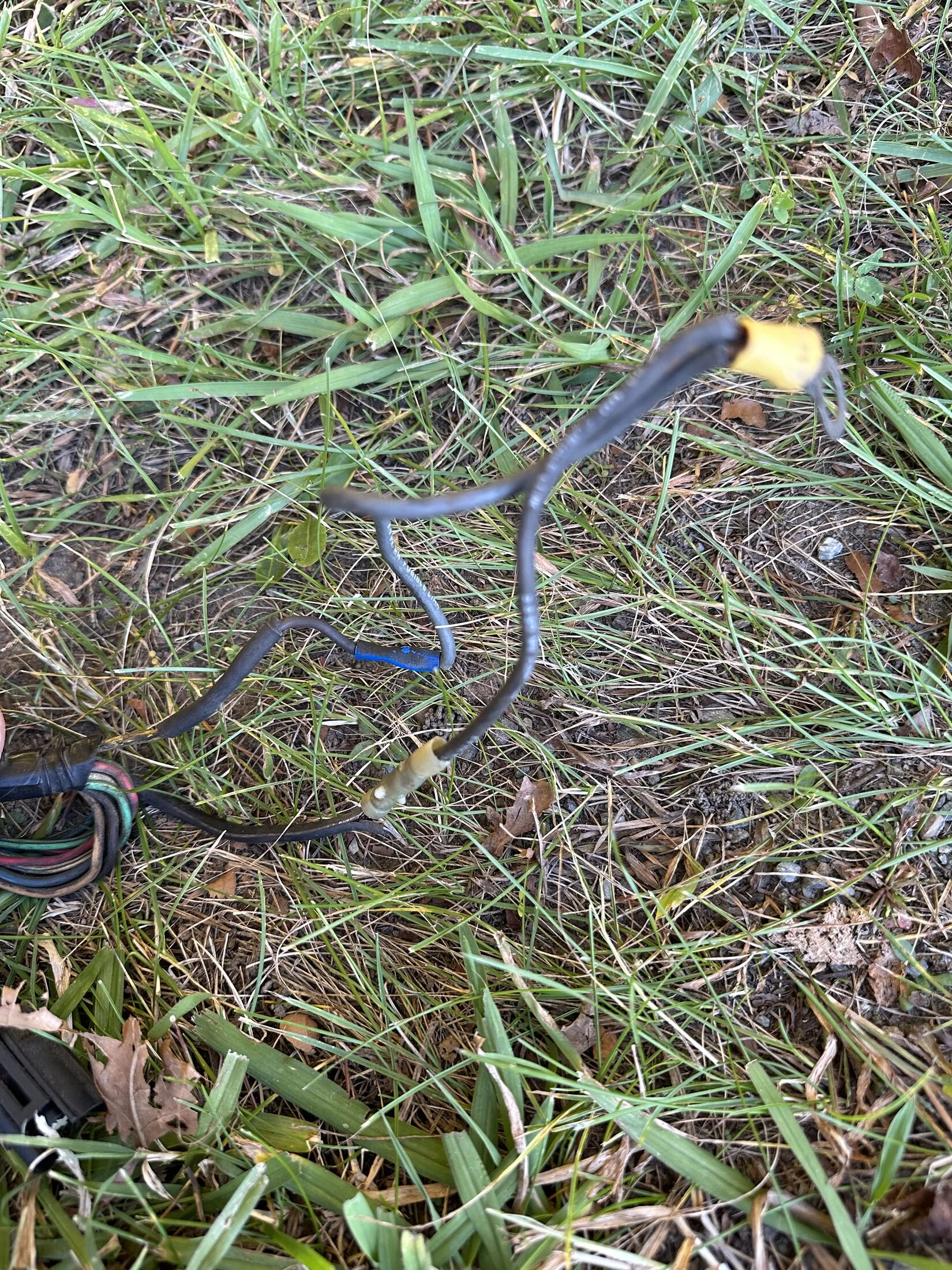

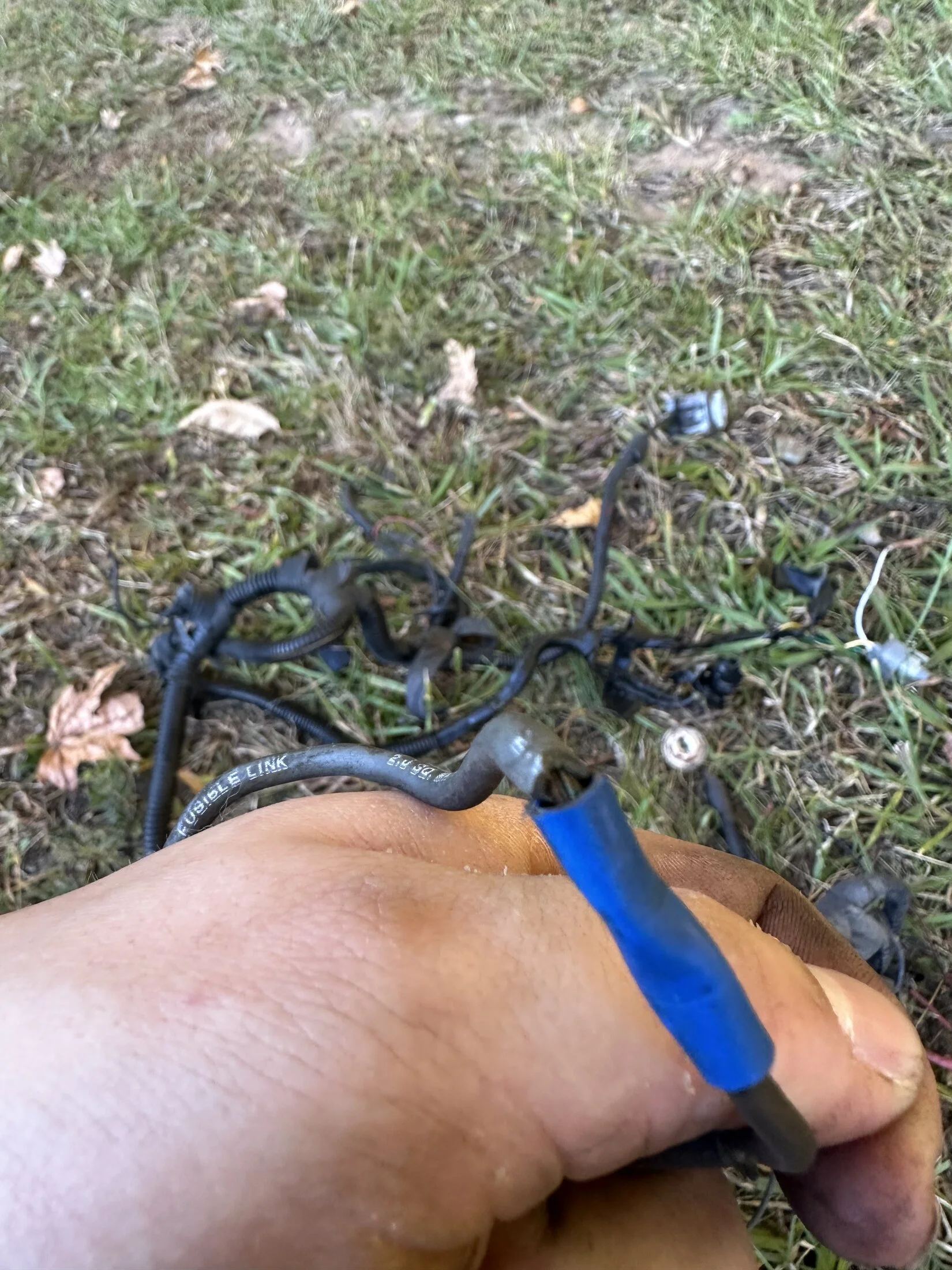

I haven’t had a chance to do it but when I was poking around the solenoid and looking for the other end of the alt harness, I found some nasty cuts and splices that looks like someone bypassed the fusible links. The harness is also super tight where there was so much wire cut out. I’m going to check out voltage drop on that

It’s finally fixed. Took a closer look at the alternator/light harness and it was pretty bad so I ordered a ron Francis front light harness from LMR and put it in along with a new solenoid and now the voltage gauge is dead steady and so are all the lights. Only problem I’m having now is that my fog lights aren’t working. Always something.

If anyone ever has the same issue, simply checking the resistance between the yellow wire at the D plug and the solenoid isn’t enough. As stated above you’ll need to do voltage drop tests. Here’s what my harness looked like at the solenoid:
The yellow reference wire ohmed out just fine but the questionable splices and sections of wire were corroded and barely making a connection.
